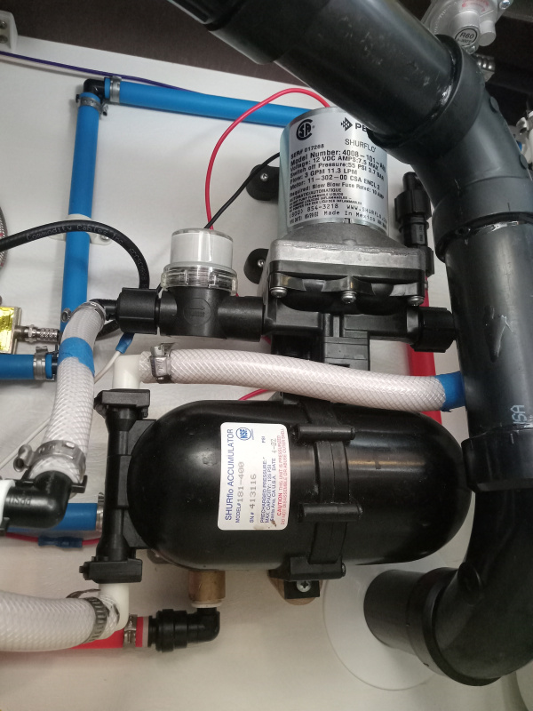

    I don't have an Alde system but I added a Shurflo Accumulator at the water pump output to smooth out the water flow and reduce pump running at low flows. An easy modification with good results…

    Accumulator Tanks, the small RV/Marine tanks added to pulse pump systems, are intended to smooth out the pressure pulses providing 'claimed constant water pressure' for at least the accumulator tank volume.

    The Shurflo Accumulator shown is an adjustable pressure air chamber separated from the water by a diaphragm. The pressure is adjusted to match the system pressure. The liquid volume varies with the system pressure and the air cushion is maintained.
    If the recommended Neo-Pure unit is installed on the cold water supply as described above, it seems the Shurflo unit is designed for the same basic function and would accomplish the needed function if the volume capacity is adequate.
