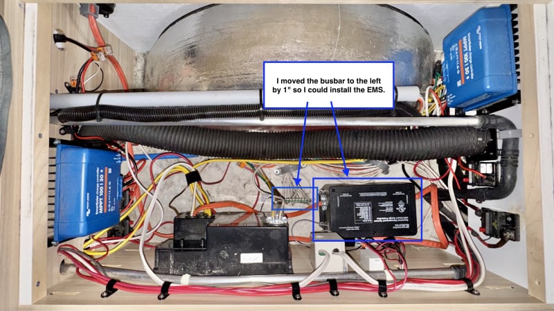

I just bought a EMS-HW30C that I will be installing soon. Saw this thread, thought I'd respond to help the next person. I asked their support and they explained that yes, it will sacrifice itself to protect your camper.There is an internal bypass switch that will allow power to go through the unit, however of course there will not be any protection. For that reason I will keep my plug-in surge protector handy.This way I can get the EMS-HW30C repaired and replaced, while bring protected by the plug-in surge protector, which won't do all that the EMS-HW30C can do, but it's some protection (better than none).

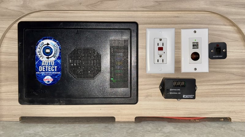

I plan to install it behind the passenger side folding back rest. Waiting for confirmation from nuCamp support on the wire spec, so I can replace the short orange wire coming from the 30A input to the WFCO with a longer one (not a fan of unnecessary splicing).UPDATE: forgot to follow up on this. I ended up mounting it on the floor right next to the WFCO. I had to move the ground busbar over a little bit to make room (confirmed with T@B that moving it was ok. I put the display next to the two outlets, so I can see it when I open the door.
