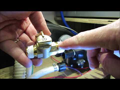

  • tabiphile
    tabiphile Member Posts: 473
    @jules2go....OK...not quite the same....the idea is to pull directly from the jug without running the antifreeze into your holding tank. To do that you plum a bypass valve into your system and use it to bypass the tank when you winterize. Here is a typical kit that you might find that does this for you. Install and leave it in place YoY so that you can do this job quickly and effortlessly. https://www.campingworld.com/pump-converter-winterizer-kit-6279.html?gclid=EAIaIQobChMIgZzbtI_k7AIVUODICh20yQ1AEAQYAiABEgIyq_D_BwE&gclsrc=aw.ds
    Here is a (somewhat droll) video that explain both the method and the installation. It's not a tab but the idea of putting the valve in place to bypass the tank is explained. Once you have this setup you simply draw the AF through you lines using the pump. https://www.youtube.com/watch?v=BGm6TJ-_AUo

    To add some info about the CAMCO 3-way valve/winterizing kit, here are some pictures.
    First one shows the 3-way valve installed between the water filter and pump in our T@B.
    The second picture shows the valve open and siphoning antifreeze through the plumbing lines. No antifreeze gets in the fresh water tank.
    Hope this adds some clarity...
