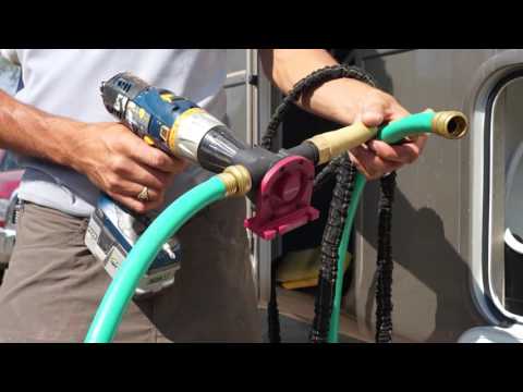

    For all you folks who like and have gadgets and power tools, this guy has an interesting and quick way to fill up his fresh water tank when boondocking.
    https://youtu.be/WtQfa_Cd6eM?t=104
