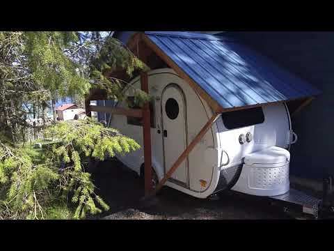

You could make your own shelter..
Part 1:
https://www.youtube.com/watch?v=_8CcyT1RAns
Part 2:
https://www.youtube.com/watch?v=_xZ9XE2YlOk
-Brian in Chester, Virginia
RV: 2018 T@B 320S, >100 mods -
@BrianZ -- I love your shelter. I'm wondering how I would anchor it to asphalt. Also wondering if I would have trouble parking the T@B without knocking down the shelter.
2018 T@B 320 S Boondock | 2015.5 Volvo XC60 T6 AWD | Seattle, WA, USA
"Blessed are the curious, for they shall have adventures.”― Lovelle Drachman -
It's not mine, @PNWtabber. He's got a bunch more..
https://www.youtube.com/channel/UCRdKCLh2lKFl_dNBNaLTnWw/videos
Agree; I would have made it wider, and longer too.-Brian in Chester, Virginia
