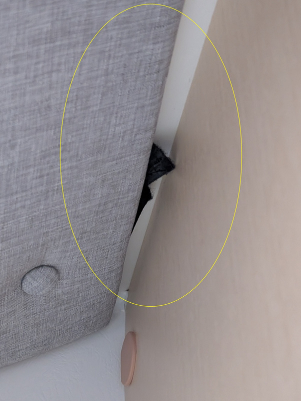

Reviving a three year-old thread! My driver's side panel in my 2022 T@B 400 looks almost exactly like the first image in the thread with 3 screws stripped. Two questions. 1: To remove the fabric panel to get some new screws/anchors/tape/whatever in there for repair it looks like I need to remove the outer housing for the stargazer window shade/screen. Is this difficult? Anyone know of any instructions to help? 2: In the upper side corner (where the bed meets the housing for the fridge/radio), there's a small gap where I could conceivable screw in a small bracket to extend over the panel and hold it in place. I've attached a photo to show where I'm looking at (please ignore the scrunched-up black velcro strip that I unsuccessfully tried to slide in there). Does anyone know if screwing into that area with, say, a couple 1/2" screws would hit anything or have something to grip into? I'm hoping someone may have tried that before - it might be a little easier than removing the stargazer window cover assuming I can find a bracket that will work. Thanks, Mark
