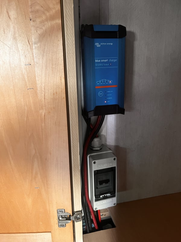

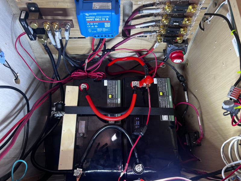

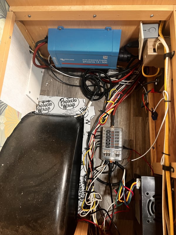

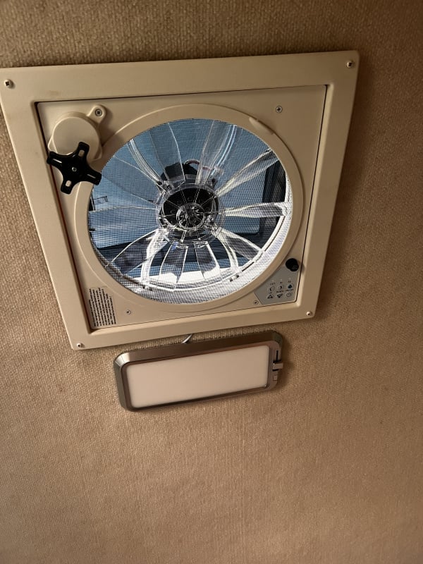

    I'm now seeing regular posts on Facebook from folks with '06-'08 T@B's having floor issues and have been pointing them toward this thread.  I assume even those floors that didn't have bad damage from leaks already are now starting to fail.
    As such, I thought I'd update with some other improvements I've made that could be done in conjunction with the rebuild.  Why not build it back better, right?
    I've now got lots solar/electrical upgrades, a new roof fan, a shower/sprayer hookup and new window shades.  All I have left to do is replace the Cool Kat, and maybe one day get a welder to adapt a new Dexter axle to the chassis, and I'll basically have no potentially-problematic components remaining.
    If you decide to do a floor swap, feel free to DM me and I can share some resources that helped me.  I am by no means a professional so certainly do you're own research and consult a professional to make sure you're doing things safely!
