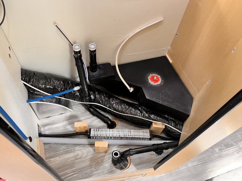

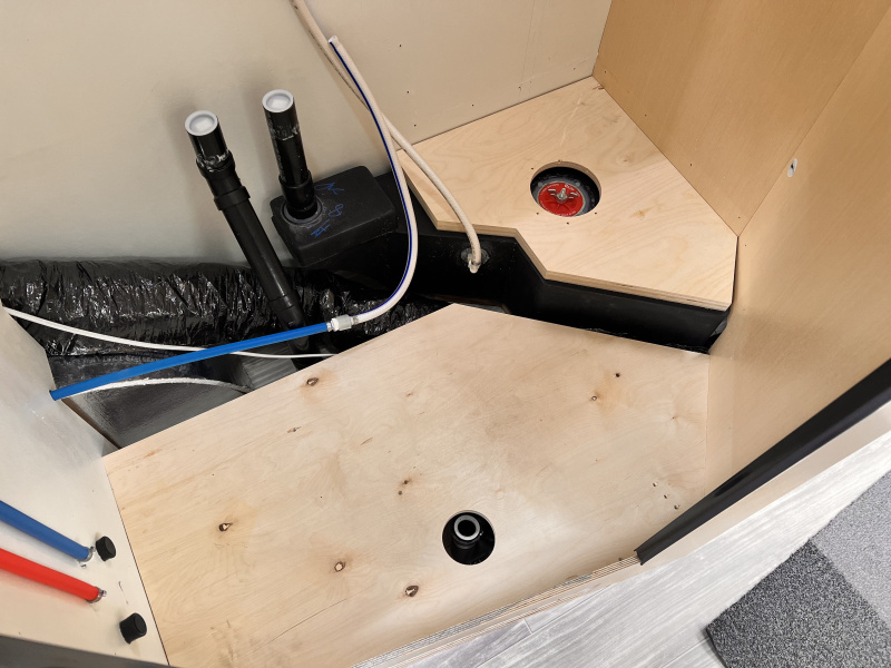

If your curious what is under that floor this is a photo I took when I was repairing the black tank flush port on our 400.
2021 T@B 400 BD
2025 Toyota Tundra / Nashville, TN1 -

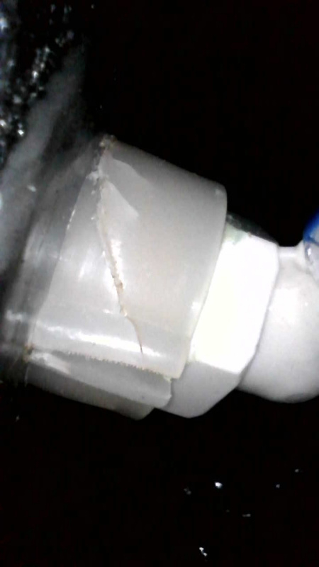

@mjwaldner
Was the black tank flush leaking where it enters the black tank? I have a bad feeling that is where I have a leak which I thought was coming from the black tank flush check valve but that wasn't the source.2021 400 Boondock / Jax, FL
2018 320-S0 -
Yes. I think it was overtightened when the camper was assembled and it cracked over time. Or it just had a manufacturing defect. I have spoke with multiple 400 owners from who have had this same problem.
I took this picture with a borescope when I originally figured out were the lead was coming from.
2021 T@B 400 BD
2025 Toyota Tundra / Nashville, TN0 -
Dang, that's not what I wanted to hear. The fix looks quite invasive. I guess one option is to just not use the tank flush. Appreciate the info and the pics!2021 400 Boondock / Jax, FL
2018 320-S0 -
I was curious to know if it only leaked when I was flushing the tank or if it would leak all the time. I filled my black tank up all the way and let it sit for some time. I looked at it through the borescope and I did not see it leak. But when I tried to flush it with water pressure it started to leak. So in my case not using the black tank flush appeared to be an ok solution.2021 T@B 400 BD
