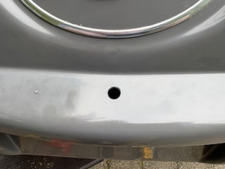

  • GordoB
    GordoB Member Posts: 13
    You referred to the outside plastic shell.....in addition to the screws, was your panel glued as well?  Mine seems to be glued onto the rest of the unit.  I am reluctant to peel off.
  • HedCount
    HedCount Member Posts: 56
    @GordoB Yes, it had some mastic like adhesive on the lower section.   I didnt remove the whole plastic panel, just the lower section enough to get my arm up to the shelf above the license plate so I could tighten the nuts holding the camera.  It wasnt real hard.  The adhesive stayed pretty sticky, but it might need to get it warm to get it to adhere well when you close it back up.
    2023 TAB 400, towed by 2001 Ford f-150 Supercrew XLT 5.6 liter v8
  • GordoB
    Thanks @HedCount !  I am struggling a bit.  I am trying to fish the camera wire through along the same path that the license plate lights go through the trailer wall.  Really having a difficult time doing this.  Did you drill additional holes to pass your camera wire through to the connection area?  I have attached 3 pics: one is the hole I drilled on the back shelf where I intend to mount the camera.  Its the wiring that I am struggling with.  Any advice?
  • HedCount
    @GordoB You are working in the same place I did.  I think I had to force a philips screwdriver thue the hole first to make a hole past the sealant that is there.  I caulked it back up after getting my wire through.
  • GordoB
    So you used the same path as the license plate light wires.....no new holes?
  • HedCount
    Yes.   Tapped power INSIDE the trailer in those wires for the license plate lamp.  Note you will have to have your tow vehicle power on and attached to the trailer to use that power
