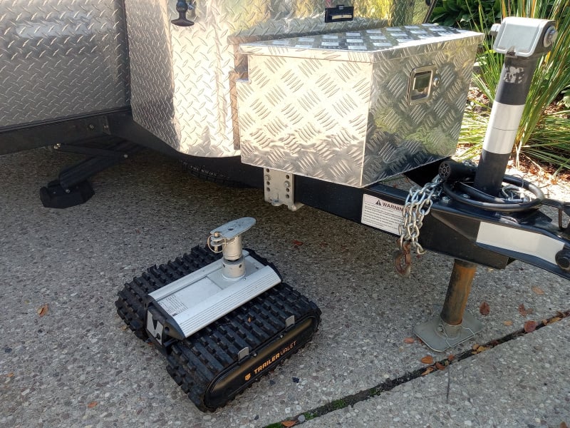

    The Purpleline movers would not work on my UT (CS-S special) because of frame outriggers right behind each tire among other suspected clearance issues so I ended up with a Trailer Valet RVR3.
    It works very well on my gravel and concrete driveways including the steps between the different surfaces.  The area is generally level.  It allows me to pull my trailer into a very tight storage shed nose first.  It's easy to use for moving my other trailers also.  Very satisfied.
    We do not bring it traveling - never felt the need.  I know of folks that carry one in the back of their truck.
    IOM - Comparable performance and maneuverability to tire driving types I've seen.  Cost is similar also although it doesn't require the installation expense.

    rfuss928 said:
    The Purpleline movers would not work on my UT (CS-S special) because of frame outriggers right behind each tire among other suspected clearance issues so I ended up with a Trailer Valet RV3.

    Bayougirl said:
    rfuss928. I need some sort of valet for my UT.  How have you liked it so far?
    I'm very happy with the RVR3.  I use it as soon as I arrive home after a trip to move the trailer into its parking place.  The small bracket is permanently mounted to the frame.  I lift the trailer off the TV ball, slip the RVR3 in place and lower the tongue ready to roll.  I switch on the remote and move the UT anywhere.
    The RVR may seem a bit pricey but are often available with a substantial discount or as "refurbished".  There is no installation costs or substantial jockey wheel requirement and no effect on ground clearance.
    These savings actually make it a lower cost alternative to a Purple Line type mover with very similar or possibly increased maneuverability.  It is compact enough, although a bit heavy, to be brought traveling if you're so inclined.
