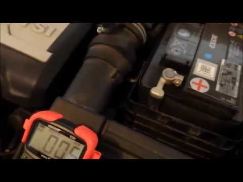

    Thanks Jenn - So in essence I'm doing the battery load test. One Youtube video from some rv place the guy turned the dial to the first setting on the right (DCV) so that confused me. The DCV setting has the two lines above the V which I think measure the alternating and direct current. Do you know why he used that setting (he was using the same multimeter that we have) as opposed to the load test?

    I have no idea why he did that. Here is another video https://youtu.be/GwyAd2DEkUA

    To get an idea of a battery's charge state, you can just measure the voltage at the battery terminals. Here's a link to a charge table: http://lestoilesroses.net/wp-content/uploads/2015/02/truck-battery-buying-guide.gif
