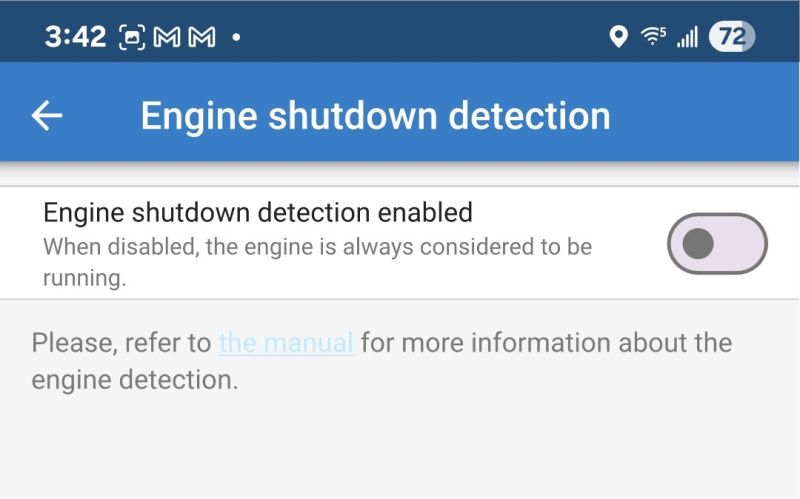

    if I set the Victron to Engine Shutdown detection ON (the default to keep from draining your auto battery) the Victron high draw is a brief instant of perhaps 22 amps that dwindles down to zero with a few seconds.
    If I set the Victron to Engine Shutdown OFF the Victron high draw is a brief instant of 35 to 37 amps that dwindles down wotihin a few seconds.  After two or three cycles this pops the 40A engine compartment resettable breaker.

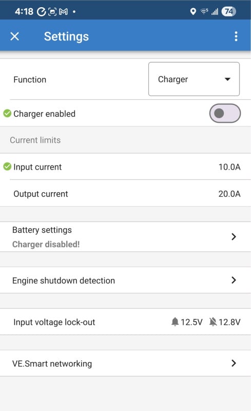

    Again, if someone with a 3rd gen. 2016 through 2024 Tacoma that should have the same alternator, and has a Victron DC charger, can pass along their Victron settings I'd be grateful.  Here is what I have at the moment:

    I realize you're looking for a simple setting to solve the issue but there are two things working against you:
    The smart alternator drops the voltage down to 12.5V if the PCM deems the battery fully charged. You would have to set the lockout lower than that to avoid it kicking in while driving but that means the battery would be discharged when the engine is off until the lockout voltage is reached. The correct fix would be to put a relay into the power feed for the rear connector which is controlled by a wire from an ignition power source.
    The basic function of a DC-DC converter is to use lower voltage and higher current to generate a higher voltage with a lower current. Some back of the napkin math with your max output voltage of 14.4V and worst case 12.5V on the input side and the 87% efficiency of the converter comes out to ~1.3 times higher current on the input side vs the output side, 38-39A. Basic rule for breakers is 125% of continuous load so the breaker should be at least 50A, better the recommended 60A.

    I finally threw in the towel on Engine shutdown detection (Esd) with my standard TV (2023  Toyota Sienna 4WD Hybrid) and Victron XS DC-DC charger.   I instead installed an ignition controlled relay in the TV to shut off the AUX 12 when the engine is off.
    With the Esd enabled I would only see charging when climbing a hill with the gas engine running at high RPM, which is exactly not what I want.
    So now I disable Esd.  I also disable the charger when climbing long hills.
    In addition I set the maximum input current from the TV to the trailer at 10A since Toyota does not specify the ampacity of the hybrid DC-DC converter.
    If someone figures out how to make Esd work with a hybrid computer system, I'm all for it.

    Set the Orion DC DC converter low parameters for engine off at 10.0v and all is well now. Charging is constant at close to rated 30 amps so I'm happy.
