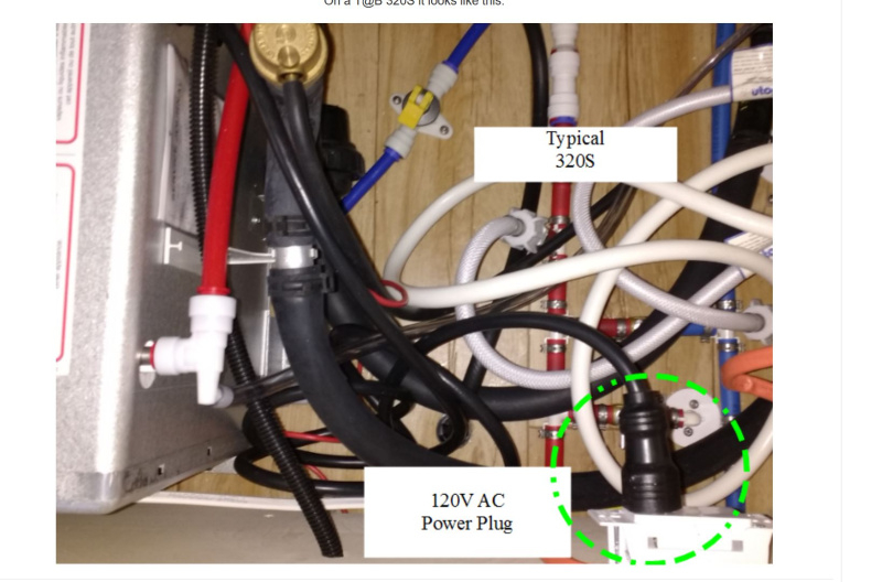

    Is the Alde plugged in under the bench?

    @ Garrit, I could be wrong, but my understanding is that the Alde panel relies on 12V power (either from the battery, or via the converter), but 120V AC is required for the electric heating elements, so I too would recommend confirming that the 120V AC plug is securely attached.

    pthomas745 Administrator, Moderator Posts: 4,561
    Picture of the power plug for the Alde in the Alde compartment.  If this plug is not secure, there can be no 120V power getting to the Alde electric heating elements.
