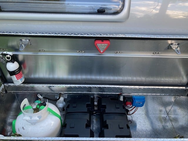

  • AnOldUR
    AnOldUR Member Posts: 1,759
    edited July 2025
    JP2558 said:
    My only other thought is to relocate the battery to the interior ...
    Consider swapping out your plastic tub with a truck box. Ours came from Tractor Supply. Plenty of room for propane, two 100Ah LiFePO4's and other miscellaneous things.

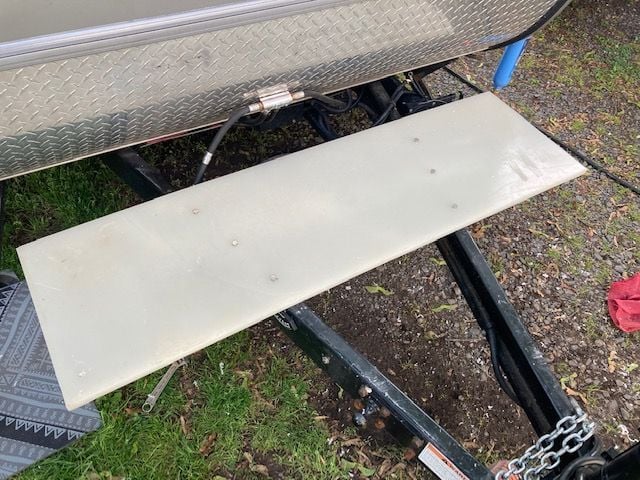

  • JP2558
    JP2558 Member Posts: 248
    @AnOldUR I like the truck box swap, so two questions: 1- How is it mounted? And 2 - We have a battery switch mounted on the diamond plate that is easily accessible via the open plastic tub. Did you have to accommodate one during your install? And if so, how?
    Thanks, Jerry
    2019 Honda Pilot AWD and 2018 T@B 320-CS hanging out on the left edge of Lake Erie.
  • AnOldUR
    @JP2558
    I had a 3/4" sheet of plastic that I cut to the size of the base of the box and mounted to the frame. There are other options for this. The idea was to have something supporting the bottom of the box for more rigidity. There was enough slack in both the gas and electric connections to mount them inside the new truck box.
    It's been constant change in the way we utilize the space. The second picture is from after the switch to dual batteries. It's a little different now, but it shows the gas regulator, cutoff switch and solar controller mounting.
