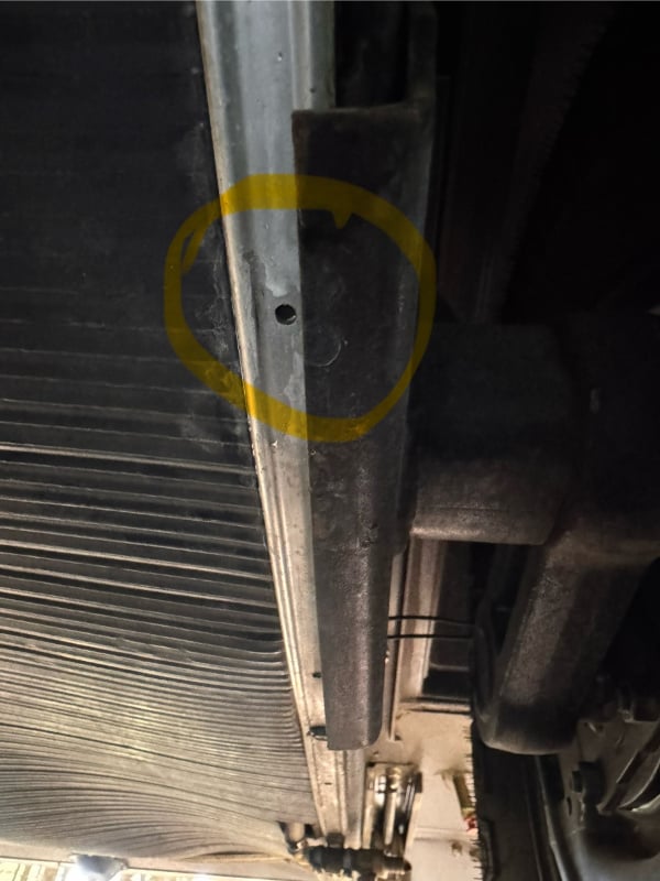

We have water dripping on the driver side wheel on our 2020 Tab400. It’s not a lot but we suspect some sort of small leak. We didn’t have this problem when dry camping and using the water pump. Now we’re hooked up to city water. When I press on the underside I can increase the watering. It seem to accumulate there. I checked everything I could think of and had access to from the inside. Under the fridge, under the bathroom sink and under the bathroom pan. Also checked the Alde compartment. All these places are dry. It could be the outdoor shower (which we haven’t used), but we‘re camping right now and I can’t easily check that.

    Are you running the air conditioner? If so, it might be condensate escaping from the pan under the AC unit and running down the edge of the trailer to the exit point that you photographed. If it seems air conditioner related, check your evaporator pan drain to make sure it’s clear. And make sure your trailer is level so the pan is level and the condensate runs to the drain.

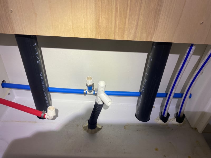

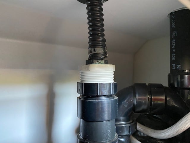

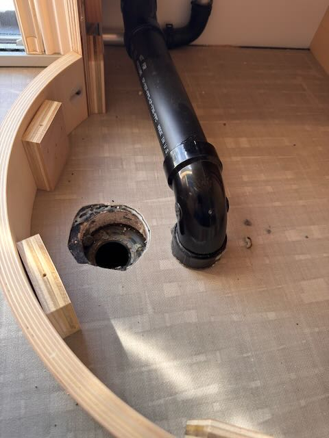

    Here are pictures from behind the bathroom sink, showing corrugated black drain to PVC,
    then pulling the outdoor shower box you can see where that goes into a trap and then into grey tank.
    I would be more inclined to pull the coroplast cover and look from below at where the grey tank receives its water to see if it’s leaking before the other.

    It is also possible that water is trapped above the coroplast cover under the trailer.  If you have driven through rain, or a big puddle, etc.  Water can wind up above the coroplast, and will simply drain wherever the lowest point is. This can make you think the leak is directly above where you see the dripping.  Press up on the plastic "coroplast" cover and see if you can feel any water slopping around above it.  If it isn't water from the rain, etc, the leak may be somewhere else entirely.

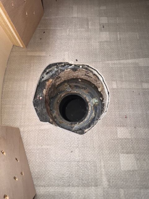

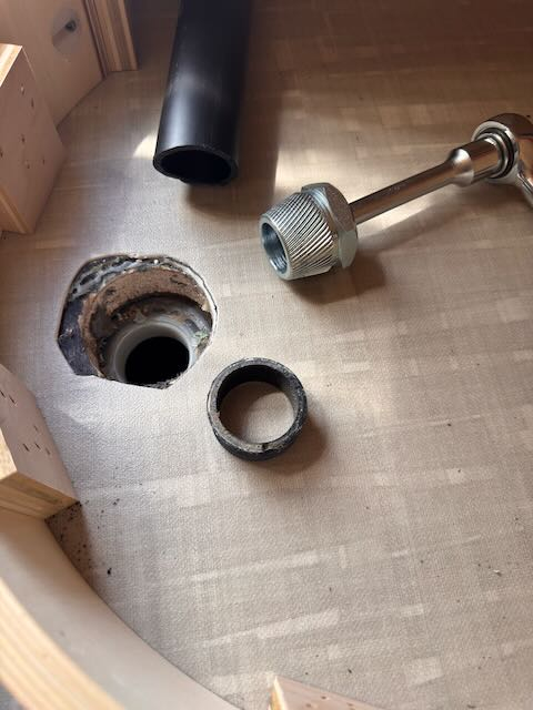

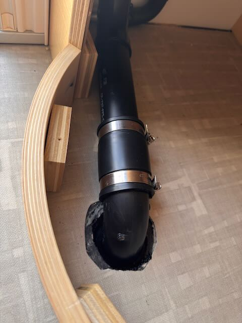

    Glad you found something and the grey tank is in front of the wheels near the center of the trailer, a large rectangular plastic tank. I have never seen a plumbing diagram but others might be able to help.
    I found this thread for a 400 and It seems to describe your issue and has good pictures. The PVC is threaded into the grey tank right under the sink cabinet. He also refers to a similar repair for the shower, which has its own attachment apparently on the other side of trailer.
    Hope this helps but does not look like an on the road type repair.
    https://tab-rv.vanillacommunity.com/discussion/16272/seriously-another-broken-grey-tank-drain
