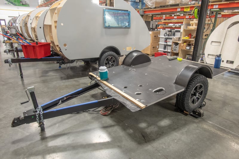

There is a good possibility that when you attempt to remove the nut(s) from the bolt threads under the trailer, the head of the bolt(s) may rotate, preventing you from easily removing the nut(s.) I confirmed the presence of several carriage bolt heads under my flooring by running a magnet across the floor (before having my flooring replaced by nuCamp.) I knew where to look for the bolts in my 2019 320S by referring to the below construction photo (not my photo, but it was taken in June, 2018, so probably relevant for a 2017 model as well.) The round silver areas visible along the flooring are the heads of carriage bolts, but most of those are for attachment of the flooring to the trailer frame below. They are located above the black Azdel underlayment, but are covered by the interior vinyl flooring.
