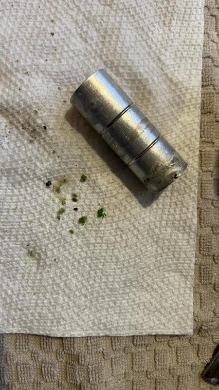

    I know that over in the FB pages, there have been at least two, one from a 2023! trailer which was discovered early this year.  The other was a 2021 400...but the info on that one was a bit sketchy.  I'm sure there are more, just owners haven't found the corrosion yet.
    The corrosion on the 2022 trailer was at the check valve just next to the Auto Air Bleed Valve.  It was severe enough to have made holes in the check valve itself, causing a glycol leak. I think we have seen enough to realize the glycol makes any difference: the newer trailers have better designed hoses and convector setups, with clamps that "seem" to be properly placed.  Many owners who cleaned their convectors in the last couple of years (almost all of these from Alde 3010 trailers)  stayed with the Century brand glycol.  With proper clamping, coating of the stub ends, etc, most of the threat of corrosion will be greatly reduced.  Many of those repaired trailers will be coming up on their "2 year" cycle fairly soon, and it will be interesting to see what they find.
    Picture below of the 2023 320 with the corroded check valve.
  • manyman297
    manyman297 Member Posts: 1,436
    @pthomas745 Crazy to see any corrosion on a 3 year old system. I wonder if this is a defect in the material and not necessarily the glycol?

    @manyman297. Between the small sample size and with no investigation into the actual cause, the question remains unanswered for now.
