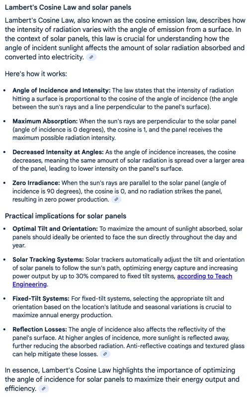

@Trailpixie, what brand/design panels are you using? Have you tried adjusting the angle of the panels in relation to the sun. Often, when I do that, it increases/decreases the wattage being sent to the solar controller.
The ratings for solar panels are done with very favorable parameters that are kinda unrealistic. I recently came across a data sheet that listed STC (standard test conditions) and NOC (nominal operating conditions). Differences: 25C vs 46C temperature, 1000W/m2 vs 800 W/m2 solar irradiance resulting in 128W vs 100W output. Solar cells are semiconductors and as all semiconductors perform worse as they get hotter. I've never seen more ~130W from my 200W rated panel either.3
It gets stranger with curved solar panels, like those mounted on T@B rooftops.Don Montalvo | Retired Veteran | Full time boondocker

A buddy told me to Google "Lambert's Cosine Law and solar panels":
