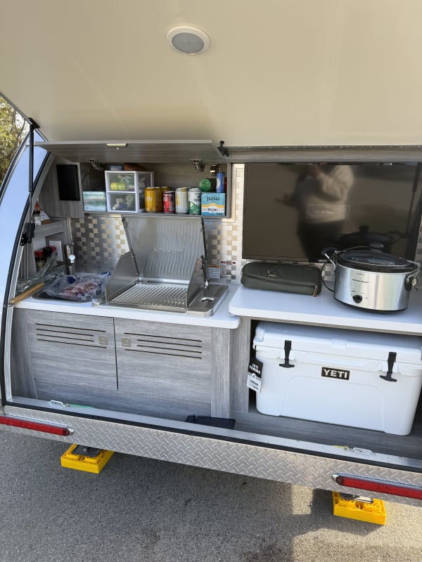

2023 Tab 320 CS-S. This outdoor grill is such a nuisance. It’s only successfully lit once. There’s no separate pilot button. It’s all built in to one button that you press and turn, but it seems not to work. Have no problem with gas lighting the Dometic burners on the inside - only the back. Any advice?

Hi Jbing, I have the same trailer. I use the furrion grill and find that for the first use it takes several tries to get it to light as the air needs to get purged out of the gas line running to the back. Will it light using an external lighter? Lastly, there is an electrically operated safety valve on the gas line to the furrion. This is controlled by a switch on the strut of the rear hatch. This ensures that if burner is left on it will not leak gas when hatch is closed. Valve, switch, or wiring could be defective if you are, in fact, getting no gas to furrion. JordanUltimate Toys Teardrop Camper

Hi jbajor! This weekend it finally worked for me! I believe I hadn’t purged enough air out of the line. Had such a great time entertaining on it. Worked perfectly! Was able to sear off a couple chuck roasts on it! Thanks for the tips. Hope you’re enjoying your CS-S. As a first time camper it’s opened up a new world for me!
