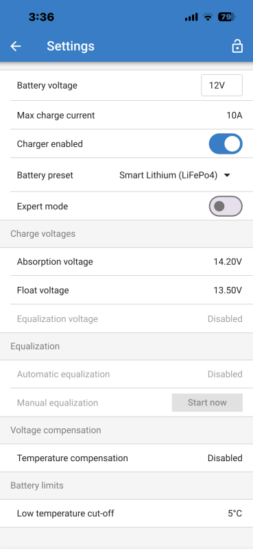

Thanks for the advice. I am pretty sure I have the Victron controller that connects the T@B solar panel to the batteries set up correctly for Lithium. When have decent solar it has not problems keeping full charge on the batteries. I couple things I have not mentioned: 1) I installed an port for a second portable solar panel into the diamond box that feeds into these batteries, and that has it's own controller. It seems to be working, but I usually don't want to bother hooking that up due to weather and theft considerations. We almost always are boondocking. 2) I had the NuCamp dealer install the two batteries inside the trailer, under the sink, as you can see in the photos attached. I did that so we had more room in the diamond box for other stuff, but also because I was concerned about theft of those valuable batteries. So I don't have to worry about moisture in terms of a shunt. It was a bit of a pain to get the wires necessary fed from the diamond box into the inside to the trailer where the batteries sit, but it's working. I will attach the photos so you can see the setup. I'll start looking into the shunt idea in the meantime. Thanks so much! -
That is a nice setup! The shunt will help....and when ever you get the chance, the portable solar will definitely help out on helping the batteries keep up with that fridge power use we have been discussing.

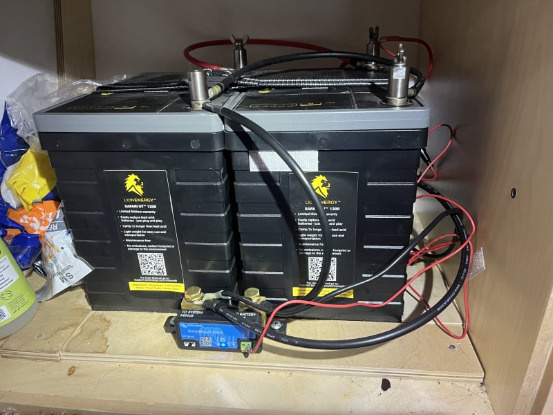

Got the shunt. Mounted it in front of the batteries. Just ordered a short jumper cable to run it to the battery. Once I get that, I'll see if I can get it working and probably need help calibrating it. One question I do have is the shunt manual says:
"Note that there should be no other connections on this side of the shunt or on the negative battery terminal. Any loads or chargers connected here will be excluded from the battery state of charge calculation."
Note I did wire the external solar panel negative lead directly to the battery terminal. Does this mean I will need to relocate that terminal ring to the "To System Minus" terminal on the shunt?

OK. I'm back. I got the 8 AWS wire, and have installed it onto the "To Battery" post on the shunt, and the negative terminal on the parallel battery setup. I have also put the negative wire from the external solar panel on the "To System Minus" of the shunt, as well as the negative cable that runs to the master disconnect switch on the trailer system. Right now, the positive wires from both the external solar panel and the installed trailer system line are both attached to the positive terminal in the parallel battery setup. See the photo attached. I now have two questions:
1. To protect the batteries when not being used, ChatGPT tells me the best option is to set this up, so everything disconnects when the master switch is off. That was always the case, but now, with the shunt installed, it is going to itself exert a draw on the batteries if it is on, unless it is wired correctly to avoid this. It warns that when connecting the shunt power cable (the thin red wire): "If the shunt positive sense wire is connected ahead of the battery switch, the shunt will still drain the battery even when “off.” It says an easy way to test this is to see if once the shunt power cable is connected to the battery, if it powers on when the master switch is disconnected, it is wired wrong. It should only power on when you connect close the circuit at the master switch. Well, I touched the shunt power cable to the positive post on the batteries with the master switch off, and the shunt started to power up. So, I'm doing something wrong. It appears I don't understand how to connect that shut power wire "behind" the battery switch". What do I need to change?
2. In regard to the positive wire coming from the external solar panel in the back, can that still remain attached directly to the battery array as it always has been, considering I now have its corresponding negative wire on the shunt itself?
Once this is all working, it will be calibration time!

Because your battery disconnect switch is on the negative side of the battery, it will not disconnect the shunt power.JHornby said:OK. I'm back. I got the 8 AWS wire, and have installed it onto the "To Battery" post on the shunt, and the negative terminal on the parallel battery setup. I have also put the negative wire from the external solar panel on the "To System Minus" of the shunt, as well as the negative cable that runs to the master disconnect switch on the trailer system. Right now, the positive wires from both the external solar panel and the installed trailer system line are both attached to the positive terminal in the parallel battery setup. See the photo attached. I now have two questions:
Thanks.
Harry
The simplest solution might be to disconnect the thin red wire when wanting to completely shut down.
On systems with the battery disconnect on the positive lead, the shunt power can be connected to the load side of the switch. This wiring is more common and typical of T@Bs factory wiring.
RFuss, Bummer. OK, so if I need to do that, which end of the thin red wire should I disconnect? I notice that once I stuck it into the shunt, it almost feels like I can't pull it out again, like some sort of a one-way insert. Is there a trick to freeing it? Alternatively, I guess I would need to reach in the back and disconnect it back there. Not horrible, but not great if I just want to turn the whole thing off to save batteries when not using the trailer... which could be at least once a day. Is there something I could put into that red line that would make that super easy to disconnect without having to take the terminal ring off the battery? Thanks in advance.
The red wire does lock into the shunt. It can be released by putting a small pin in the hole next to the wire socket.JHornby said:RFuss, Bummer. OK, so if I need to do that, which end of the thin red wire should I disconnect? I notice that once I stuck it into the shunt, it almost feels like I can't pull it out again, like some sort of a one-way insert. Is there a trick to freeing it? Alternatively, I guess I would need to reach in the back and disconnect it back there. Not horrible, but not great if I just want to turn the whole thing off to save batteries when not using the trailer... which could be at least once a day. Is there something I could put into that red line that would make that super easy to disconnect without having to take the terminal ring off the battery? Thanks in advance.
If I wanted to turn it off every day, I would add a switch in a convenient location. Maybe next to the main disconnect switch.

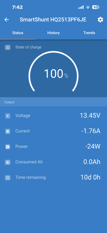

OK. So, I hooked up the shore power overnight to let the batteries fully charge. I disconnected the master switch for about an hour to let things settle out. Then I went into the app and hit the synchronize SOC to 100% button. I am attaching a snapshot of the various calibration settings I used based on several references which I assume are pretty close to good for my system. Then I turned on the master switch to put a load back onto the battery. I have no lights or refrigerator on anything I overtly have powered up. As you can see, it shows a draw of 1.76 Amps. That seems to me to be a lot and will drain the battery in ten days (though my math would say less than that.) Maybe something is going on just now and it will settle down, but this comes back to the very original question I had on this thread: Where are the power draws coming from when supposedly most of the power is off that is still killing my batteries? Any thoughts?
JHornby
A baseline draw for typical T@Bs as delivered is ~.35 amps. This is certainly the case for ours. Your reading of 1.75 amps is extraordinarily high.
Possibly by pulling the 12 volt fuses one at a time you can find which circuit and ultimately what component is causing this current draw.
The Victron Smart Shunt draws less than 1 milliamp (<.001 amp) per specifications. Even the .25 amp measurement indicated is far too high for it alone.

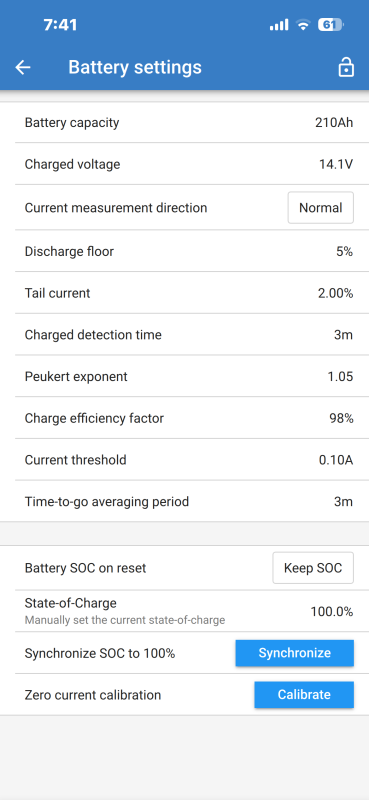

Have a look at your battery manual and check on the "Charged Voltage" or "Absorption Voltage" For many lithium batteries, the charged voltage should be "somewhere" around 14.4 to 14.6. So, 14.1 "might be" just a little low. The "Discharge Floor", which is used for the "Time To Go" calculation, should be set to "zero".Let's also have a look at the Solar Controller settings.This is the Battleborn page for setup for the Shunt for their batteries. There are a lot of discussions across the internet about the "tail current", for example. Check the LiOn battery manual to see their recommended settings for charged voltage, etc. They probably do not differ very much from these values.Lets also make sure your Solar Controller is properly set up for lithium charging.As far as this drain goes, though: has there been any modification of something like the reading lights? The 12V ports? Do you have something like a phone charger or some other device simply plugged into a port? Is your 12V fridge completely "off?"This is a thread about a 12V fridge that is "constantly running" due to a bad thermostat. The suggestion of turning off the various breakers and pulling one fuse at a time while watching your Victron react would be the best way to go about this process of elimination.
Towed by 2014 Touareg TDi -
QHumberd,
Thanks for the compliment. This is pretty challenging for me, but it looks like the shunt is working and already I can see how valuable it is going to be to figure out how much draw almost everything puts on my battery array as well as just know where things are at. It's actually kind of fun! And again, without the folks on this thread I'd be dead in the water, starting with the suggestion to not only use a shunt, but exactly what one to get.
Pthomas,
I had mostly referenced this video for guidance on how to set the shunt up: Victron SmartShunt settings explained in detail

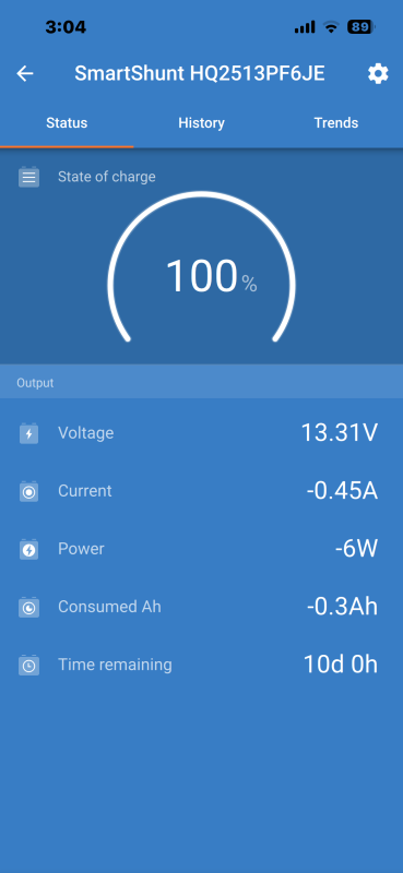

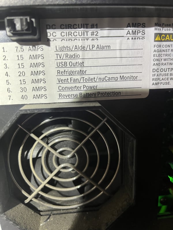

That said, I did some troubleshooting by pulling the fuses as suggested by RFuss. Here is what I learned as I pulled each fuse one by one... first, see the attached photo of the fuse panel for reference for what it controls as I go through each one by one. That photo is called "Fuse Panel".
1. When I pulled this fuse, the amps dropped from 1.75 to about 0.45. Wow. I looked at the Alde control panel, and it turned out that even though I had no shore power or any designation on it to run the heater via electricity or propane, and therefore the trailer was room temperature, the panel itself was still on. When I powered off that panel, that is what dropped the amps from 1.75 to 0.45 basically. So, there was a lot of the mystery solved.
2. The TV/Radio... I went up to the Jenkins control panel, and actually turned it off. That reduced the draw by 0.07 amps.
3. USB Outlet. No significant draw.
4. Refrigerator. It is fully turned off, and the door is closed, and it showed no draw.
5. Vent Fan/Toilet/nuCamp Monitor. No draw.
6. Converter Power. No idea what this is, but when I pulled that fuse the entire amp draw went to zero. I assume this is some sort of master fuse that rules them all?
7. Reverse Battery Protection. No significant draw.

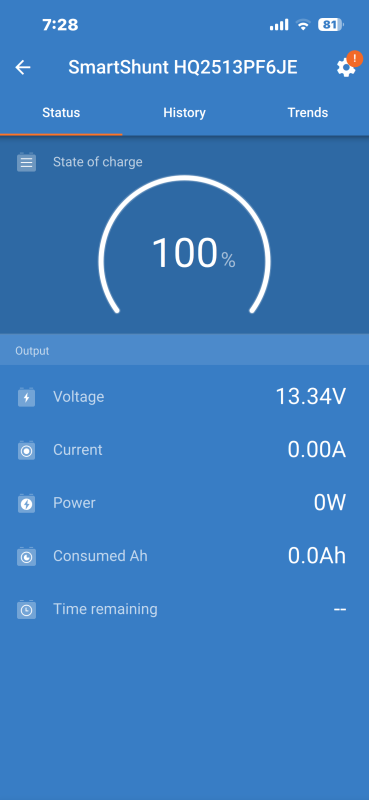

The last picture I am attaching I am calling the "Base Power", and that seems like it is the power from all the systems after I have turned off the easily controllable systems. You can see it is coming in at about 0.45 Amps, which seems like it might be in the acceptable range?
While I was at it, I did fool around with turning on various lights and the refrigerator, and it was really cool seeing how much draw each one added. The refrigerator of course ruled them all.
Oh, and one more thing. I just took a screen shot of the Victron Controller settings that manage the factory-installed solar panel on the roof of the T@B. Hopefully this helps figure out if I somehow screwed something up with that. It is called "Installed Victron Controller Settings".
