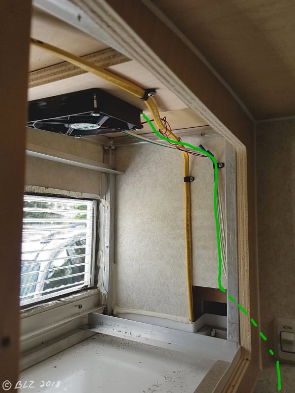

The AC compartment has a "drain pan", and the drain pan may be cracked. The AC drain in your 2017 is toward the front of the trailer, so when you do use the AC, if the trailer isn't a tiny bit "tongue down", the condensation cannot drain from the trailer. The photo below shows the AC compartment, with the drain in the front corner of that area. The drain spout exits the trailer just in front of the driver's side tire.The "cracked drain pan" involves the area underneath the AC unit, which has been known to crack and need to be recaulked. Not too hard to get the AC out, and there are several threads about it.
Towed by 2014 Touareg TDi3 -
The drain could also be plugged.2015 T@B Max S (320)
As mentioned, window mounted A/C needs to have camper tilted forward slightly to drain properly. Our 2018 developed a crack by the drain tube behind the shower mirror. Removed shower mirror and used combo of flex seal and flex tape to seal. Use A/C drain cleaning pellets to keep clean and odor free. Replaced stock mirror with round porthole mirror that opens so can access drain area and periodically run long wire down drain tube to clean. Main maintenance items are caulking, ALDE and water hoses/connections, replacing ALDE fluid, keeping all tanks clean, inspect/grease wheel bearings and inspec/maintain proper tire pressure. Going over 75,000 miles this year and still doing fine. I'm sure it will serve us just fine for many more years. One of best purchases we've ever made.
