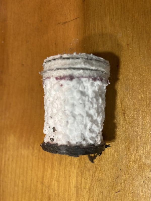

    I don't know what the floor system is on the 360, but like @GBL_citruscountyfl, our 2020 320 floor is Azdel and can not rot like the older one's that had soft spot issues. Just read that "while the 2020 320S floor was a thinner sandwich of Azdel and foam that often felt flexible underfoot, the 360's system is designed to be more rigid.
    Here's a cross section from when I cut a hole through it.
    Yes, but my 400 floor is 3/8" plywood, foam, then the black material exposed to the underbelly.  I've taken core samples when I've run things through the floor, so I have a sample like yours.
