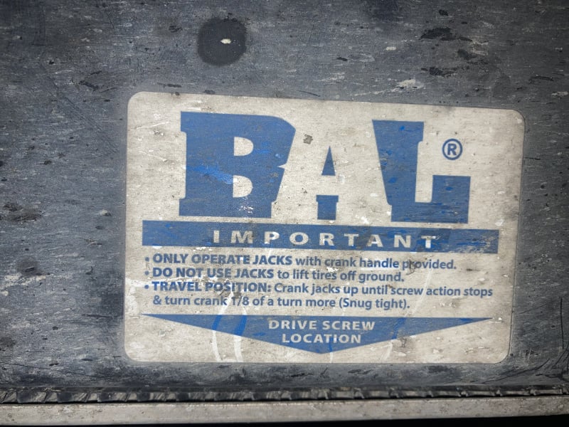

Just a heads up. Sure it's done by many owners, but if you strip the thread using a drill BAL will void the warranty.
