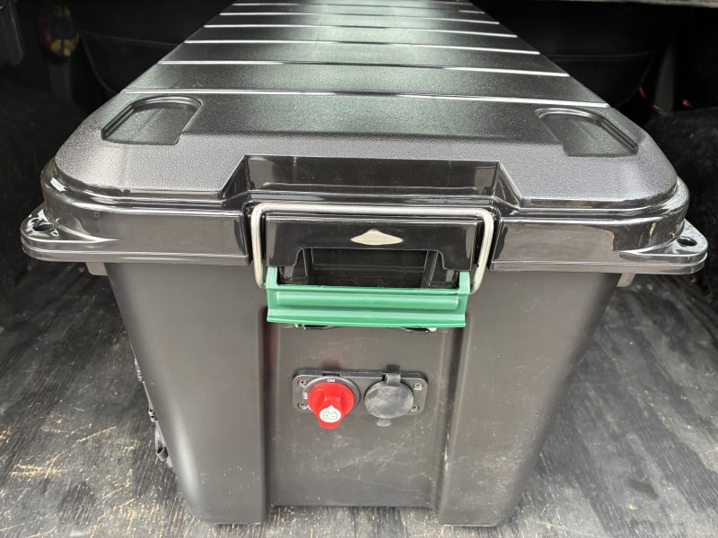

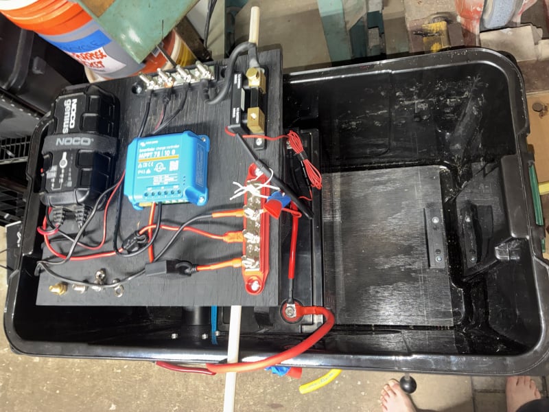

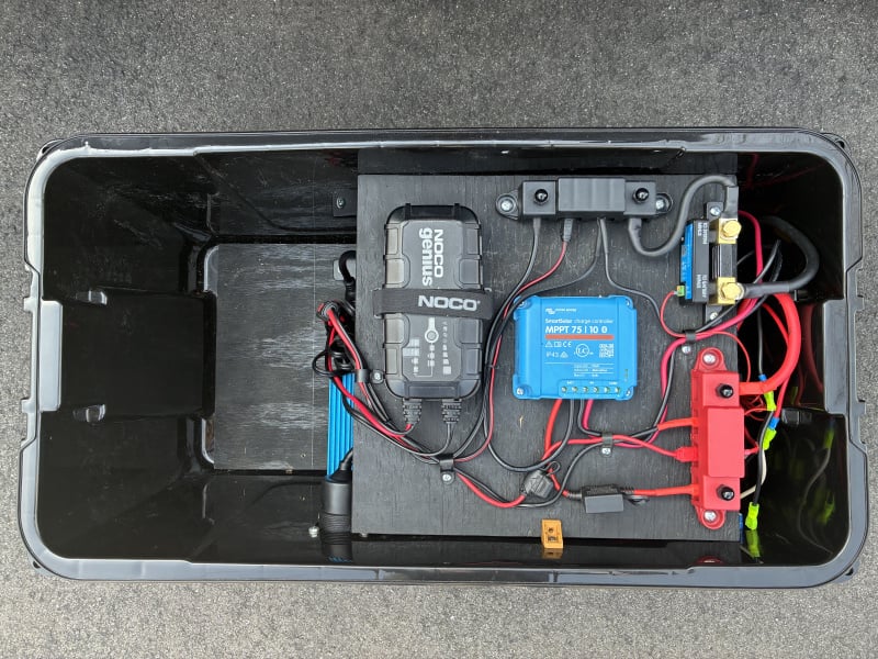

I'll have to eat some crow here. When forum or Facebook threads come up from members using power stations, I'll chime in saying that an onboard battery upgrade is a better option if you don't need the power station for uses outside of camping. Now here I am building a power station.

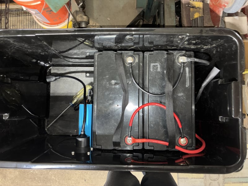

This started because I upgraded our onboard 100Ah batteries with newer, more compact 300Ah. That left me with two LiFePO4's with a lot of life in them. We carry a 12V compressor fridge in the back of our Wrangler and keep it set as a freezer. Works great for keeping frozen foods for longer trips along with making ice cubes for drinks. I've used different ways of powering it, but wasn't satisfied with them. Repurposing the old batteries made sense.
We won't be able to give the system a good test until we head out for our first longer trip at the beginning of May, but I have my hopes up that this will be worth the time and cost of the components used. We had the little 375W inverter that we used for blowing up an air mattress when tent camping. It probably won't get much use mounted in this build, but we'll see. The solar controller was left over from when I upgraded our rooftop panel and needed a new larger controller for it. I also already had the NOCO charger. Everything that I needed to purchase came to about $220. I'm not sure about the overall cost benefit, but it was a fun project that should be useful.

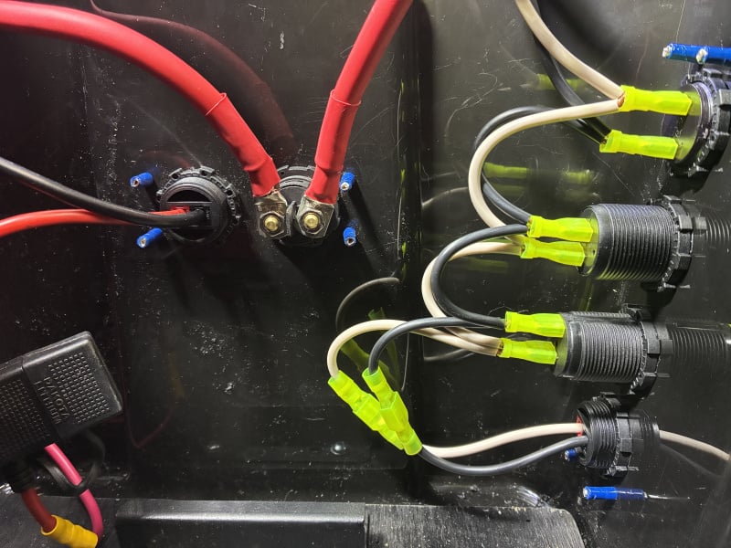

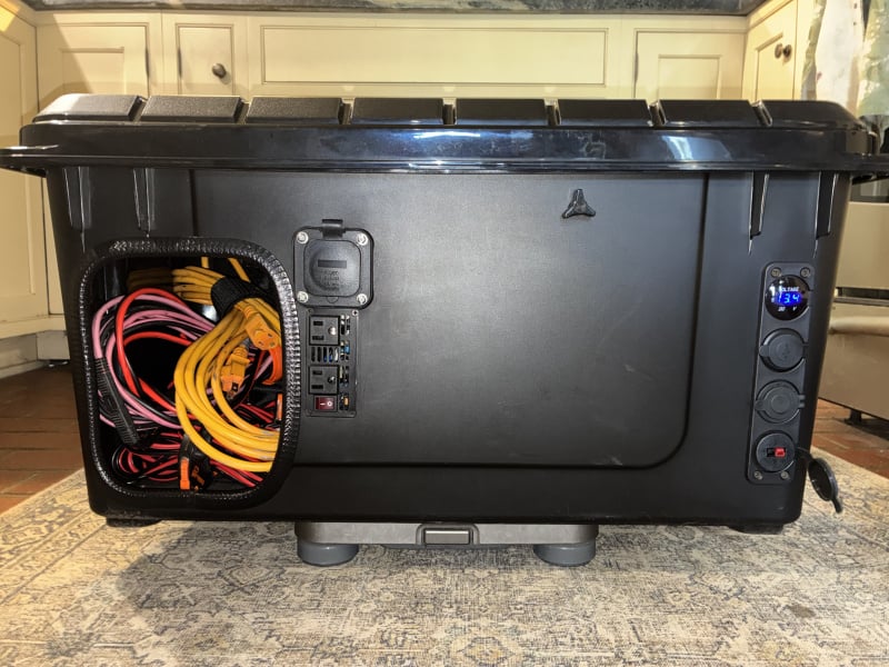

2 x 120V AC Outlets
120V Power Inlet (for charger)

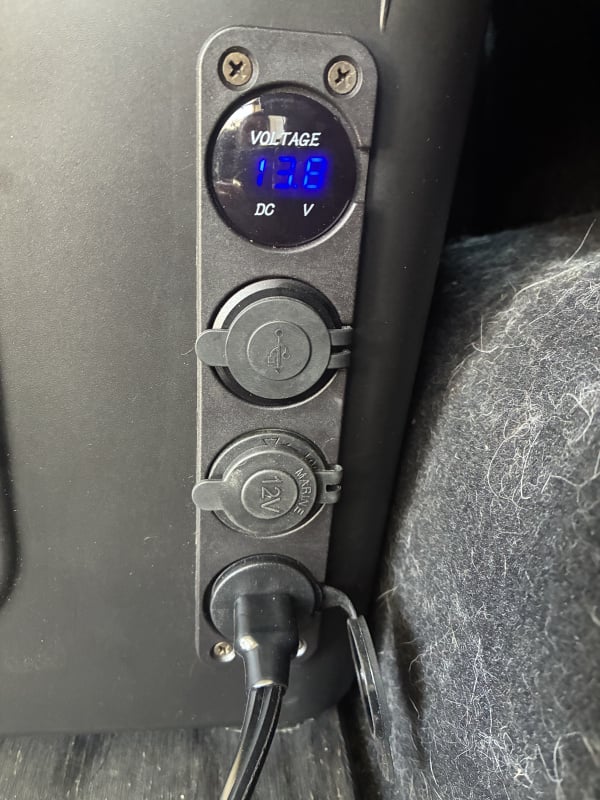

12V Volt Meter
Type C and QC 3.0 USB Sockets
Cigarette Type Port
Anderson 45 amp Port (output)
Anderson 45 amp Port (solar input)
Disconnect Switch

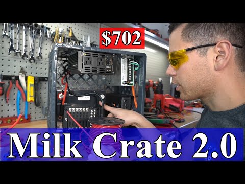

I am also guilty of saying all the same things about power stations! When my propane fridge died a couple of years ago, I used my original lead acid trailer battery to support the 12V fridge I now carry. It was nice to get the 12V fridge out of the trailer for a little legroom, and the extra battery was useful for that. My portable panels could recharge it easily. When the old lead acid finally showed signs of giving up a year ago, I purchased a 50 amp hour lithium battery. Worked fine.Then I stumbled across the Will Prowse "milk crate" power station builds. He laid out the plan in detail, so I ordered the various parts and worked one up. Not at "finished" at AnoldUr's here, but it works quite well. The larger inverter handles my laptop that I carry better than my smaller inverters I use inside the trailer,and I can charge it on shore power or solar. It was a nice project for me, just one more step of my Tab Education.Here is the Will Prowse video for anyone who might like to jump in.
Towed by 2014 Touareg TDi3 -
Nice video @pthomas745. I'm a Will Prowse fan, but I hadn't seen this one.

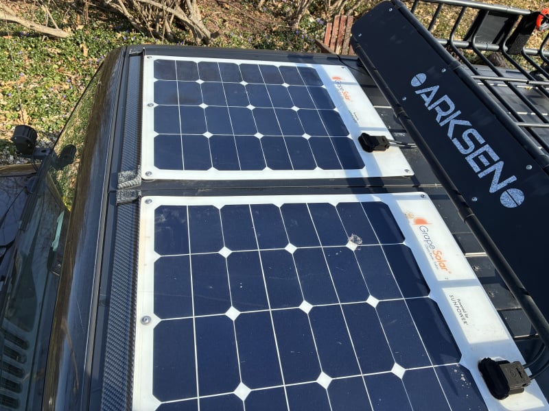

The 100W's of solar on the roof of our Wrangler falls short for the 200Ah's of battery, but should extend the charge some. I now have the power station in the Jeep running our 12V freezer to test how long it will last.Stockton, New Jersey
I let the freezer (set to 10 degrees) run for a week in the back of the Jeep. Not great sun this time of year, with a couple of rainy days. The highest yielding day from the 100W's of solar was 310Wh with an average about 200Wh per day. Expecting better when we get back on the road later in the year. The freezer was empty, so not too efficient, but even running as a freezer, I don't expect it to use more than 400Wh per day during summer heat.
So, even at a potential 200Wh deficit per day this power station should give us close to two weeks (hopefully more) before needing to recharge. Not too bad.

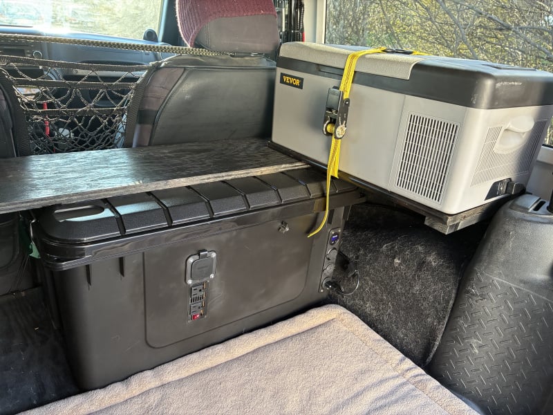

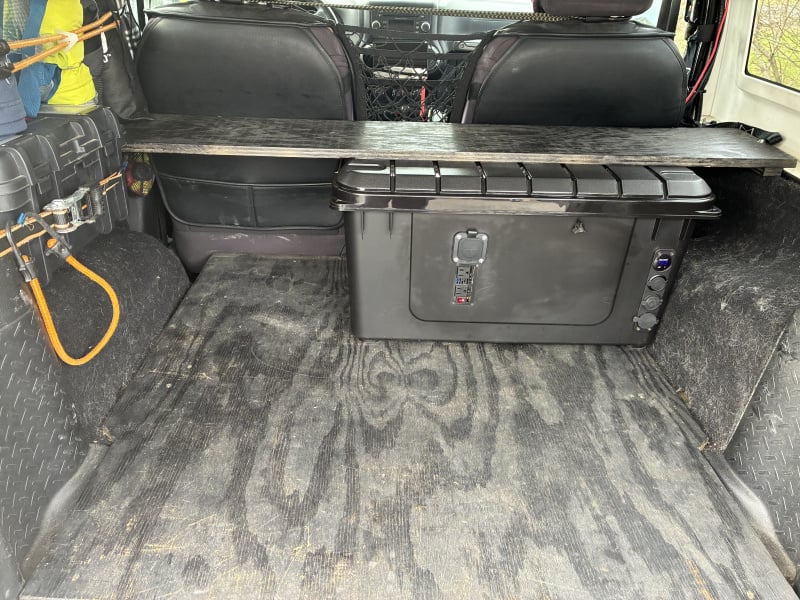

With this new setup, the plan is to leave the cooler in the Jeep all the time. Since it's used as a freezer, we don't need to access it too often. An additional benefit is having ice for drinks when away from the campsite on day trips. If I hadn't already had most of what I needed for the project, I probably would have stuck with what you're doing, but have high hopes that it will serve us well.Stockton, New Jersey

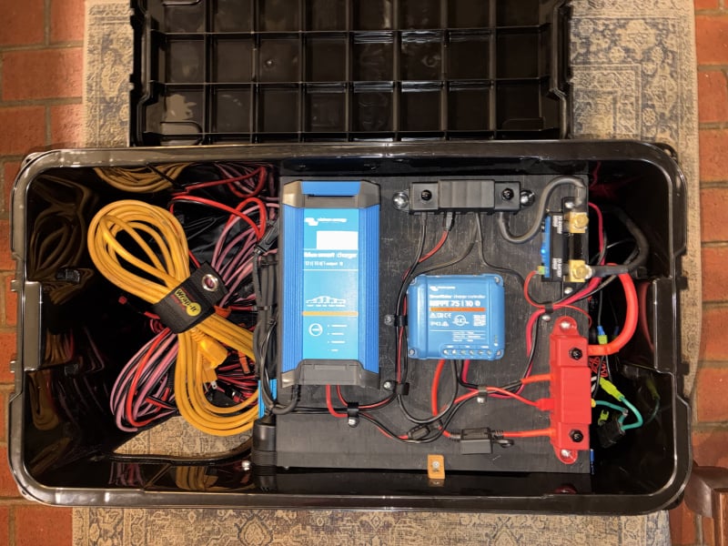

I found a better use for the NOCO as part of a battery backup system at home, so went to a Victron 15 amp IP22 for the power station. Also, where the power station is situated in our Jeep it made accessing the extra space in the box challenging. I cut a window in the front of the box for storing electrical accessories.
Heading to Canada at the end of next week. This system will be put to the test on the Newfoundland and Labrador portion of the trip.Stockton, New Jersey
