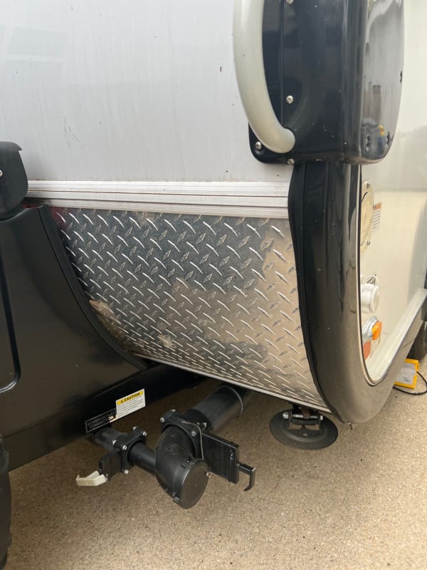

So this removal effort will be the entire bottom of the RV, or just the area pictured below...which looks like I would need to remove the propane tank and protective black plastic compartment. Did you find it better to lift the trailer somehow, or was the clearance in general enough? One additional question...are most of the connectors/hoses things that could be replaced with trips to HomeDepot...or do I need to plan for ordering stuff from NuCamp...and possibly waiting? The blue hose looks like some form of PEX.0
@spfrancis65 , did you read through the discussions I provided links for?
It is highly likely that you will not need to remove the coroplast.
You first need to do some troubleshooting to determine the likely location of the cause/source of the water leak. For example, is is from the fresh water inlet (where a hose from a campground/your residence connects to the trailer to supply water on demand), or is it possibly leaking from a hose connected to the water pump, or water line leading to the fresh water holding tank (which supplies water when you use the 12V water pump)? They are separate (but interconnected) means of supplying water via your water lines (to sink, shower, toilet) and Alde hot water tank. The issue may be as simple as hand-tightening a screw nut on the water line connection. OR, it could be a pipe clamp (e.g., PEX water pipe clamp, which requires a special tool).
WHERE TO START: The leak source may be reachable through the compartment door behind the toilet, where the water pump is located. It is not easy working in that area, so it takes a nimble person. There are other discussions on this forum about that. It is not easy to explain (simply) in writing how to do the troubleshooting, because we do not yet have enough information about the likely source of the leak. It is just guesswork based on experience at this point. Using a flashlight and small mirror will assist you in seeing inside that compartment, but even then it is difficult to see all the water line connections. The photo posted by @pthomas745 is a good representation of what is inside that compartment, but it is only a guide to how the connections are configured. The large black item at the bottom is the gray water holding tank. The black water holding tank (small) is above that (hidden), but is actually located above the interior floor, beneath the toilet. (IMPORTANT NOTE: The reason I indicated that you likely will not need to remove the coroplast cover to locate the leak is because removing the cover will not provide you access to the plumbing in the photo posted by @pthomas745. That is because the holding tanks will prevent you from seeing/accessing the plumbing. The only way to get to that plumbing, without removing those tanks, which you don't want/need to do, is through the compartment behind the toilet).
Regardless of the above, if you do ultimately decide that you need to remove the coroplast, you will not need to remove the propane tank tub. It is not involved in removing/reattaching the coroplast.
The coroplast can be removed by simply getting under the trailer and removing the screws. It just takes a bit of time and a lot of maneuvering around on your back. My 320S is a Boondock model, so a bit easier. I have never had to crawl under a standard 320S, so I cannot specifically comment on how easy it is to move around under it.
IF the coroplast does need to be removed to make repairs, although you might be able to get by with just removing the screws at the front end and lowering that part of the coroplast, it may be necessary to remove the entire coroplast cover, simply because it is fairly stiff and you would not be able to fold/bend it out of the way to get to the area(s) you need to work.
The blue pipe is 1/2" PEX for the cold water lines; red is for hot water. BUT, again, you don't need to worry about that for now, and it is very likely that you will not need to replace any of the PEX. You could very well just have a loose connection. Until you determine where the leak is, you can't determine what, if any, parts you may need.
