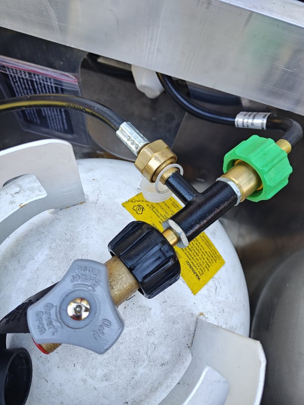

Plan B: Install a "Y" or "T" on the outlet of the 20 pound LP cylinder as Gomers2 pictured. This will allow you to use any grill/stove…and a longer hose too. You will be "somewhat" limited to grill/stove location.
My choice? My end game for my camper is for my wife and I is to travel 3-4 weeks at a time, touring national parks. Being limited to griddle only, or grill only, meals is not an option. We ended up buying a Camp Chef Everest X2 camp stove, Lodge cast iron reversible griddle plate and a 5 lb LP grower kit. I may install a tee at my 20 lb tank as well, as Gomers2 pictured; Nice to have options.

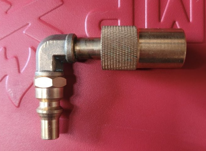

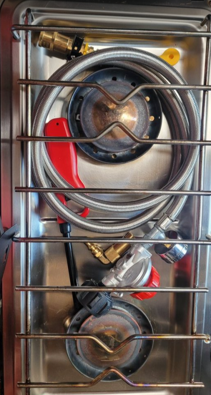

@phillm47 I also recommend the Camp Chef Everest X2, great stove. The only complaint (for me) is that the propane connection is a stiff propane tube that exists the side of the stove for the tank connection. After digging a bit, I found a guy who converted the stove's original propane connection to a quick disconnect. With that conversion, I can easily attach the propane source and not have that bulky setup. I tend to carry and extra 20lb tank anyway so this way the stove setup is very easy to use.= but it is a bit of an investment
https://www.youtube.com/watch?v=1ctUZQRORE8
I changed up his parts links a bit to reduce cost. Also got a regulator with pressure gauge so I could set the regulator to 15psi rather than just eyeballing the flame.
These are what I used:
hose w/regulatorwgauge:
https://www.amazon.com/dp/B07P5KPZ1T?ref_=ppx_hzod_title_dt_b_fed_asin_title_0_0
Quick connect plug:
https://www.amazon.com/dp/B06Y3HTK8W?ref_=ppx_hzsearch_conn_dt_b_fed_asin_title_2
Right angle qk:
https://www.amazon.com/dp/B081PY77YB?ref_=ppx_hzod_title_dt_b_fed_asin_title_0_1
Sacrifical regulator:
https://www.amazon.com/dp/B0BVVCMDZG?ref_=ppx_hzod_title_dt_b_fed_asin_title_1_0
3/8"flare to 1/4" NPT:
https://www.amazon.com/dp/B0BW6YF467?ref_=ppx_hzod_title_dt_b_fed_asin_title_0_2
Basically:
1. take hose w/regulator/Gauge, add 3/8" Flare to 1/4"NPT then add in QK plug to 1/4" end
2. Remove the knurled end from right angle QK, remove the knurled end from the end of the sacrificial regulator and attach to the right angle.When completed, it all fits into the stove for easy packing.

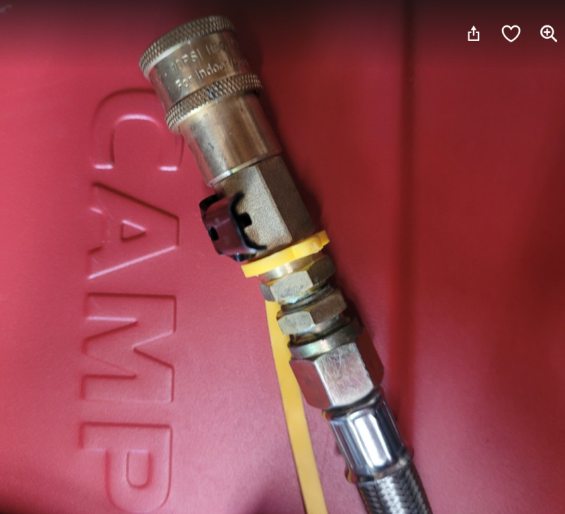

I did something similar with a Camp Chef Kodiak (the Everest’s little brother). I added a dedicated shutoff valve at the tank Tee fitting for the stove line, and then ran that line to the stove. The extra shut-off valve allows me to keep the gas flowing to the camper while cutting off flow to the second line when the stove isn’t hooked up.
I found that I need to open that dedicated cutoff valve halfway only at first when I start the stove, otherwise the higher pressure from the LP tank overwhelms the low pressure regulator for the stove. Once it’s fired up I can open the valve the rest of the way.SO, I’ll be adding a second cut off at the stove, between the gas hose and the stove regulator. I found the connector fittings on Amazon for less that $20, and I already have a 1/4” NPT shutoff valve on hand with my air tool stuff.
@abriddell and anyone else following; the following is from Camp Chef tech support ~ "Most Camp Chef stoves feature a safety bypass valve. If the propane tank valve is opened too quickly, the stove's regulator can lock into a low-flow safety mode, starving the burner of gas and causing a weak, yellow flame."
