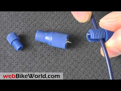

    Agreed, especially since the typical quick splice connectors at auto-supply stores are red 22-18 gauge (blue is 18-14). Neither size will necessarily match the gauge of wires you are trying to splice. The wrong combo can damage the wire strands reducing voltage down the line or make a poor connection to what you are trying to power.
    In general the best connection is soldered with shrink wrap, closely followed by butt connectors with crimper or wire nut connectors depending on application, then quick splice connectors.
    However, there are superior quick connectors for butt, splice, and nut situations. They are reusable and tool-less.
    They're called Posi-Lock, Posi-Tap, and Posi-Twist connectors.
    I found them here: http://www.webbikeworld.com/sale/posi-locks-for-sale.htm
    https://www.youtube.com/watch?v=N64p6ndlTQ8
