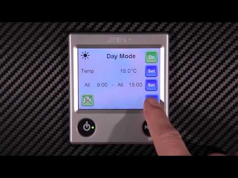

    @gkillmaster you don't need to use the hot water tank for the heat to work.  If you have a 320S with the bathroom the glycol tank is located on the driver side rear by the speaker.  You will see a square drive screw you will need to remove in order to open the panel and check the tank.  The heating system circulates the glycol through radiators in the back of the camper and under the passenger side bench seat.  In order to heat the unit you just turn on the ALDE and set your desired temperature and select either propane or electric.  For hot water you need to make sure you have water in the tank and then on the ALDE panel select either 1 or 2 on the shower icon to start heating the water up, you will also need to select to use shore power signified by the lightning bolt icon and select either 1kw or 2kw or tap on the flame icon for using propane to heat it.

    @gkillmaster excellent!  Glad you found it.  Thats correct the system for hot water and heat are separate but contained in the same unit.  The glycol circulates through the radiators found on the back wall and under the passenger side bench.  There are a separate set of rubber hoses that contain the gylcol for the mini radiators in a loop configuration. The ALDE has a circulator pump that circulates the glycol through this system, its sort of like a radiant heat system you find in a home.  Here is a little video to explain it: https://www.youtube.com/watch?v=0JjZAayAqS0
    Also here is how to use the control screen:
    https://www.youtube.com/watch?v=CJmPeiltGAU
