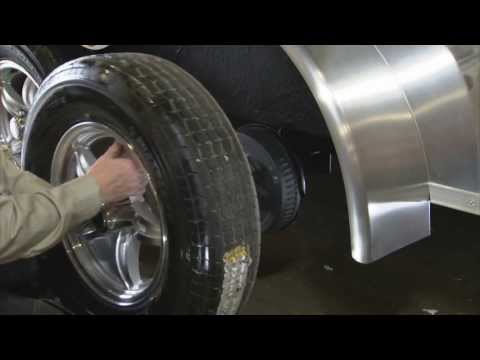

Bearing Maintenance Video:
https://youtu.be/GnH-h3W9XvI
Hub Lubrication Video:
https://youtu.be/WzW1kK8oWkc
Sharon / 2017 T@B CSS / 2015 Toyota Sienna Minivan / Westlake, Ohio1 -
Top video is the way I always did it. I did not receive a dexter manual in the new trailer literature package. Now I need to pull off the wheel to see if I have a grease zerk in the hub.
