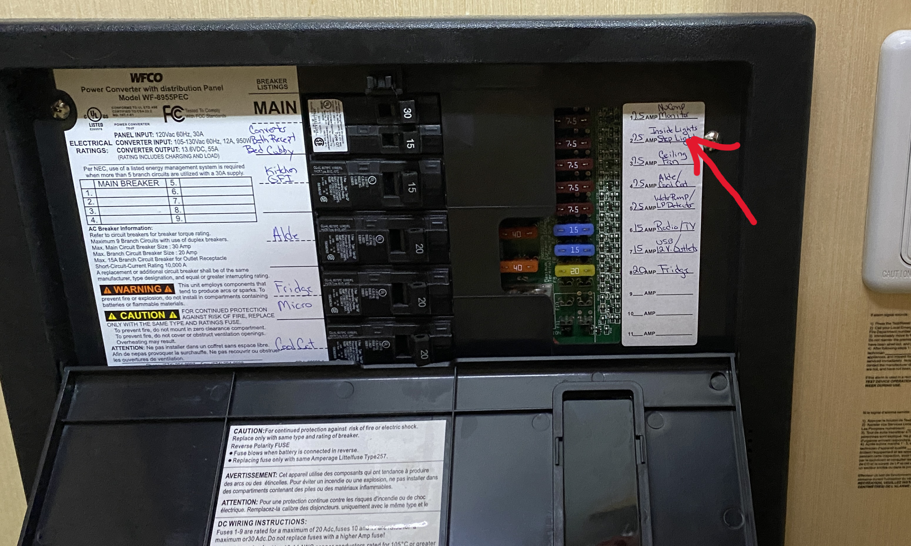

    Anyone already know which fuse that step light is wired to?
    Yes, it’s lazy to ask here - but if someone has already done the work, why repeat it?
    Thanks in advance.
    qhumberd Administrator, Moderator Posts: 885
    On my 2019 the step light is on a 7.5 amp fuse with the other inside lights, so you may want to check the requirements of the things you would be needing to connect

    I bet it’s the same one on mine then. The 7.5a lights.
    Thats OK because I was planning on using a 7.5a in line fuse anyway - mainly because I was not too sure of the length of run for that wiring…
