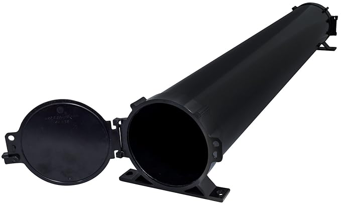

Hey y'all... I saw this by happenstance and fell in love (if one can actually fall in love with anything dealing with a black tank!!! LOL!)... has anyone put this on their wee rig? It's the BAL 28802 DumpCaddy:
I know most people have the Valterra AO4-5094BK and I almost bought it until I saw this beauty!!!!
Thoughts? Suggestions? Winning Lotto Numbers? :)  All kidding aside, would it work on a 2018 320s?

    I loved it when I saw it, but I think it is too long for the T@b.
  • GidgetGidget Member Posts: 64
    Aw, man! That's a bummer... *sigh* I was totally willing to shell out the $100 for one of 'em.

    From Amazon's specs (which are notoriously inaccurate, I do admit) it says: 48.5 x 8.4 x 8.4 inches That doesn't seem too long to me. I'll go to BAL's site and confirm that figure.

    Surprisingly, zero dimensions are listed on BAL's website. But I see this on Wal-Mart's
    48.00 x 6.00 x 6.00 Inches  So, I'm thinking it's somewhere in the middle which wouldn't make it too long, right @jkjenn?

  • jkjennjkjenn Member Posts: 6,400
    Where were you going to put it?
    On the passenger side, where everyone else puts their Valterra version.
    But the tank gates are on the driver side...how will this help support the hose on the passenger side?
    Right, that's where I wanted it but honestly, I've not been under the camper to see if it would fit over there or not. All the photos I've seen have the hose "holder" on the passenger side. Of course, this works entirely differently so it would HAVE to go on the driver's side.

    So, @jkjenn ... will it still not work?
    It has been a while since I researched and I did not examine putting it on the tongue, so I do not know.
  • ScottGScottG Administrator Posts: 5,589
    I pondered lots of options when I was planning my sewer hose carrier project. As far as I can tell, there's no room to mount anything on the driver's side. There's not much flexibility on the passenger side either, but it's a moot point as mounting the BAL Dump Caddy on the passenger side (opposite the dump valves) would defeat its entire purpose.
    I ultimately ended up taking a cue from others here on the forum and mounted my carrier across the front, behind the tub. Having used it several times now, I really like it, as there is very little wrangling of the hose to get it into position for dumping. Ultimately it seems like that's the whole point of the BAL Dump Caddy...
    Granted, this was a moderately advanced project, but as someone who dislikes futzing with stuff (especially stuff covered with human waste) I've been very happy with this solution.

    I might see if this will work with the toy hauler. Nothing is ever perfect. Even if it fits, I wouldn't leave the hose connected full time (not sure they'd even recommend that.. probably just for show in pict). It almost looks like it's for campers that have their outlet inside an outdoor cabinet. These campers have swirly things in their black tanks to keep them clean and pumps to empty both tanks *sigh*.
    As a microbiologist, I have an issue with closing up ends of the dump tank hoses (or water hoses). Many bacteria love the lack of oxygen. In dump hoses, that's not a good thing. Airing out a hose between dumps with the ends open (or you have holes in your carrier) is optimal. This is after you give it a good rinse with the dump station non-potable water for a million minutes (j/k about the million). :)
