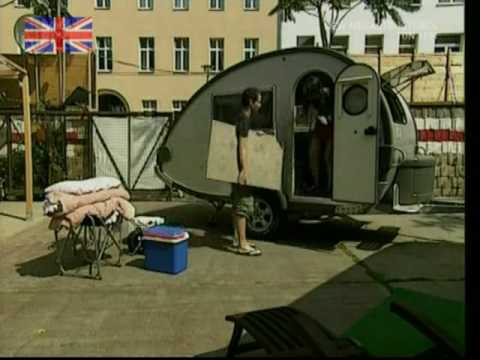

    According to this video of a T@B being constructed in Germany, the base is made of plywood. Pretty sure it would need to be something like that in order to be strong enough to walk on.
    https://www.youtube.com/watch?v=DbFV-b0drXA
    Ben Trelease & Eleanor Bell - Seattle, WA - 2009 T@B Bell@luna TV Subaru Forester
    Makes sense, other than when I drilled my pilot holes for my table it sure did not respond or feel like wood.  There was no resistance to the drill bit or any wood shavings or splinters that came up or stayed on the bit.  Could be I was not paying attention, who knows.  I look forward to the factory answer.
