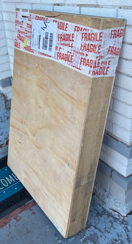

    Look what you showed up on my doorstep! Man that was super fast. They told us it would be March but it is here. Hopefully it’s the right window. I haven’t opened it yet but it’s 60° today so this is the perfect time to try it. Just so you know, they covered it completely and it dropped shipped from the manufacturer. There was absolutely no cost to us, even though it was beyond the normal warranty. But they’ve had enough problems with it that they took care of it.

    @ColleenD2 glad you got it sorted. NuCamp replaced my  2019 front window a few years back for a defect and I was second owner. It was very quick.

    Holy smokes! This was one of the hardest things we’ve ever done. It took about 90 minutes. It didn’t come with any instructions and getting it in the slot was REALLY hard. It also took me about an hour to pry the wooden crate open before we started.
    We called and spoke to an engineer at the distributor and they sent us a video showing one being taken out but it gives you some idea what to do. You have to remove the set screw and slide the track out and to the right then mount the window in the track and sliiiiiide it back in. VERY hard to line it up to get it in place, even with two people. Thankfully we have a Boondock model so that gave us a platform to stand on.
    https://www.youtube.com/watch?v=fGBU1Xj9-7o&feature=youtu.be
    I am proud of myself for solving this from the starting problem to finish, that’s for sure! This window is working better than either of our other two. Dana at Missouri teardrop replaced ours a few years ago. The left piston never worked though so the window was held up with the right only.
