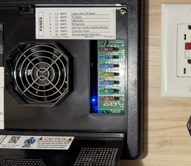

    Well I think I nearly ran it dead before I plugged it into house power yesterday.  I'll confirm that I have the correct LED lights displaying.

    . . .  to confirm, I want to see Blue for LED and Red for bulk charging?
    Correct for Li-Ion Battery in bulk changing mode of the two-stage profile.
