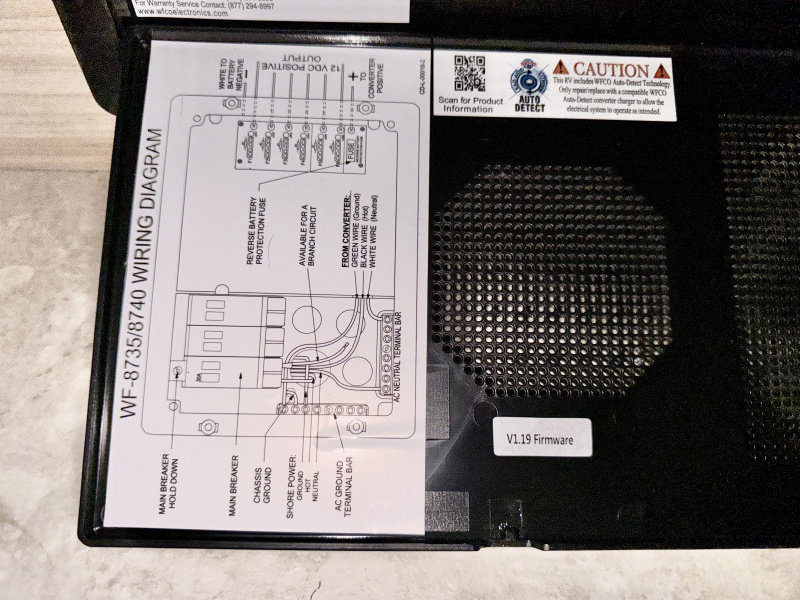

    2024 320S Boondock Black Canyon. Came with a single 100ah LiFePO4 battery, a 100|30 MPPT, and a 500A|50mv smart shunt. I added a second battery, a second MPPT, and an inverter. I might go to an RV park once every couple or few weeks, and I know the AC, microwave, etc., all work.
    Unsure how being on shore power charges the LiFePO4 batteries, if it does it, and if so how, does that work, etc. Is there a way to confirm? When I'm driving I'm guessing my vehicle heavy duty alternator is sending some power to the camper batteries (guessing not much). When I'm boondocking, the batteries are being charged by solar.
    I have thought about confirming if power is sent to the camper battery when the Jeep is off, and maybe installing a DCtoDC in the camper, and running a dedicated wire from it to the Jeep's heavy duty alternator. I hate that I'd have to handle connecting and disconnecting the wire though.
    Here is my WFCO 8735...the cover shows Firmware "V1.19", assuming the sticker is correct.

  • pthomas745pthomas745 Administrator, Moderator Posts: 4,267
    The reason I brought this up is that a couple of owners of 2024 and 2025 trailers over on the FB page are asking about why their shunts are not "synchronizing".  Of course, there were several Victron controllers and shunts that were not configured for lithium charging, or had the wrong battery setup.  (A continuing problem!)
    One owner's controller and shunt were configured properly, and they had the trailer on shore power for a few days.  With the WFCO "blue light on".
    But: the WFCO would not synchronize their shunt settings, since (I have to take their word for this) the WFCO was reaching the "charged voltage" and then immediately dropping back below that number.  The shunt requires at least three minutes at the "charged" voltage value to synchronize.
    A call to WFCO and the owner got the same old advice: run the battery down to a certain lower level. They suggested dropping it about 20-30 amp hours, instead of the advice from a couple of years ago to bring the battery all the way down to 10 percent, etc.  And then let the WFCO "auto detect" the battery.  This is with the "blue light" constantly on.
    The firmware version on this owner's trailer (a 2025 Tab 360) is V1.21A.
