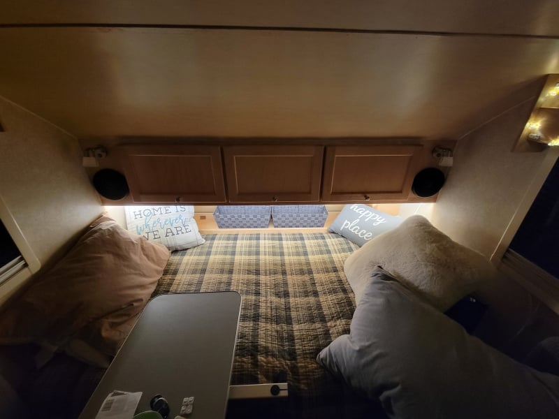

I simply added cobb led usb lights along the bottom of the back cabinets. They're peel and stick and plugged into the 12v accessory plug. They dim and they use very little power. I seldom use any other lighting while I'm in my camper and they are great to use while watching a movie. If I want or need the bright reading lights for whatever reason, they're still available this way.
2018 T@B 320S / 2024 Chevy Blazer RS AWD / Phoenix, AZ0
