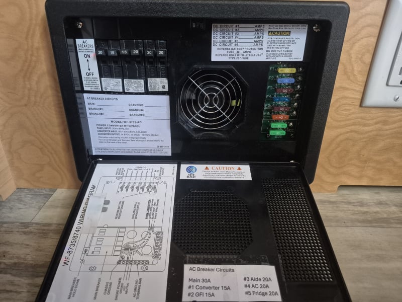

    @drackus the WFCO 8735P is one complete unit that cannot be taken apart. It's hardwired together unlike other WFCO larger amperage models. I had to replace the whole unit when I upgraded mine from WFCO 8735P to WFCO 8735AD (auto detect) I'd imagine that if @JP2558 is switching out his unit, he would have to switch out the entire power center because: 1. you cannot replace only the converter in the WFCO 8735P and 2. different manufacturers are in all likelihood not compatible components.
    @JP2558 Do you have a brand name for the new converter number? It doesn't look like any WFCO component numbers and I've seen posts on forums whereby people are swapping out their WFCO AD with a Progressive unit. Also, I wonder if they are simply going to leave your WFCO 8735P in place and add that new part no to replace the converter only or remove the whole WFCO and replace it with another brand that contains a switch.

    @drackus yes, I discovered that it was a single unit, but... I'm now wondering (edited my comment above to JP) if maybe nuCamp is planning on leaving the WFCO unit in place, disconnecting the converter only and adding another component with a switch. I'm curious now.
    FWIW, I recently rewired my WFCO 8735AD to isolate my converter on its own circuit breaker, labeled as branch #1 so that I could switch it off and use an inverter without hardwiring it into the control panel.

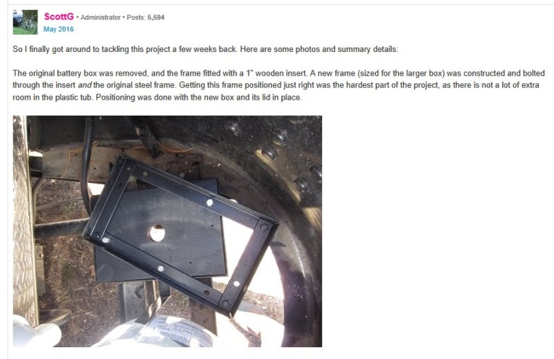

    MuttonChops Member Posts: 2,085
    JP2558 said:
    . . . not certain I can fit a group 27 box in there (to accommodate a larger battery.
    Lots of folks have converted the nuCamp Group-24 in older plastic front tub to a Group-27.  The most common approach is to place an ~1-inch filler board in the Group-24 frame base then mount a Group-27 frame or box or frame and box on top of the original.  Being sure the filler board is screwed to the trailer.
    One example:
    Forum Thread for above

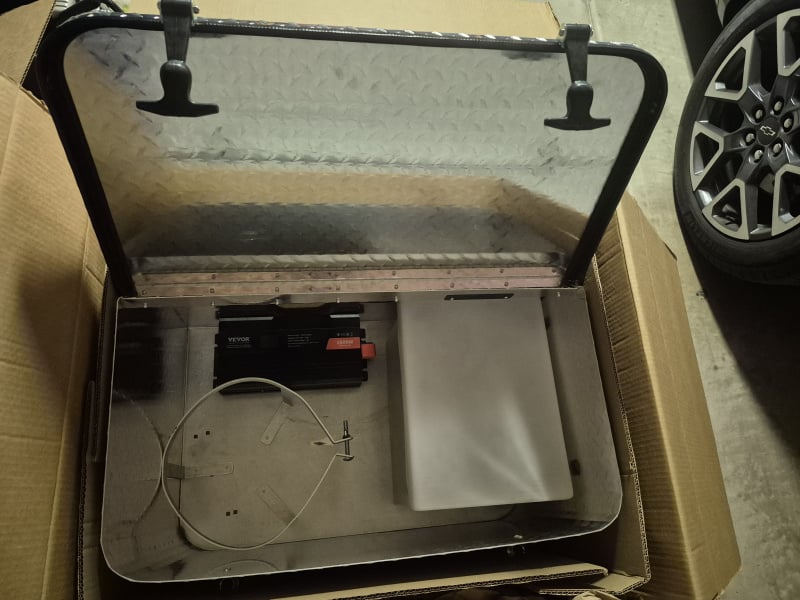

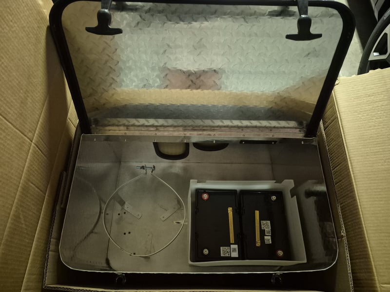

  • AnOldUR
    AnOldUR Member Posts: 1,761
    @JP2558
    I had a 3/4" sheet of plastic that I cut to the size of the base of the box and mounted to the frame. There are other options for this. The idea was to have something supporting the bottom of the box for more rigidity. There was enough slack in both the gas and electric connections to mount them inside the new truck box.
    It's been constant change in the way we utilize the space. The second picture is from after the switch to dual batteries. It's a little different now, but it shows the gas regulator, cutoff switch and solar controller mounting.
