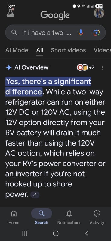

    @AnOldUR FWIW, This is what Google says about 12v vs 120v re rv fridge efficiency. I didn't ask about a 3-way, just the electrical options.

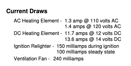

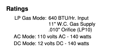

    I noticed that too, but this is copied straight from the Norcold service manual. That doesn't mean it is correct. The manual also states

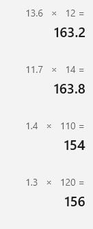

    which pans out for 11.7A x 12V = 140.4W and 1.3A x 110V = 143W but not for the other combinations. Oh well.
    Edit: The numbers make sense when you consider that the resistance of the heating element doesn't change:
    110V / 1.3A = 84.6 ohms
    120v / 1.4A = 85.7 ohms
    12V / 11.7A = 1.02 ohms
    14V / 13.6A = 1.02 ohms

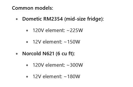

    I was under the impression that the 12V element was a lower wattage, but stayed on constantly at whatever level you set it at and that the 120V element was thermostatically controlled. Could be wrong. Lots of conflicting information on the internet.
