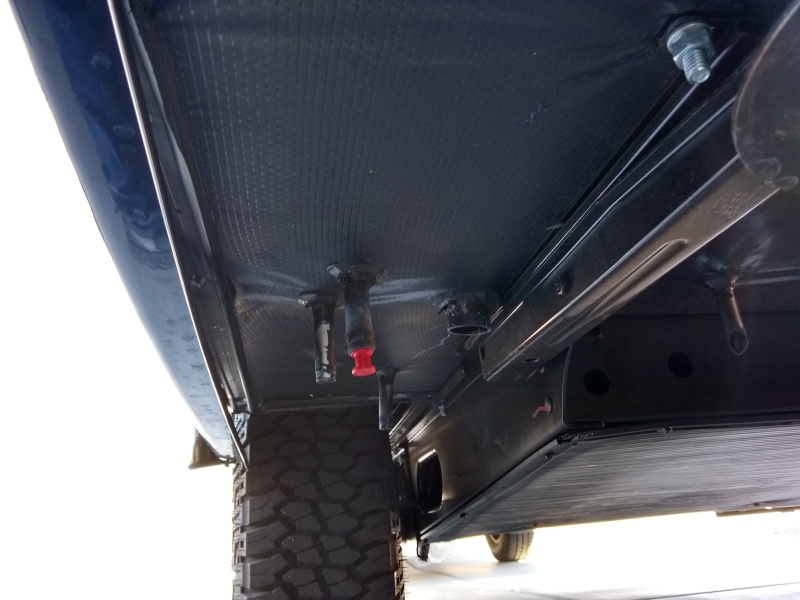

  • Bayliss
    Bayliss Member Posts: 1,534
    @DoubleDD, what year/model T@B do you have, and where is the Alde expansion tank located?  That info will help other owners assist with troubleshooting.
    Do you see any signs of leaks around/below the tank, or the hoses connected to the tank (e.g., wet areas or stains)?  Any visible cracks to the tank?  If you see anything that looks unusual, photos will help.  Also, who did the flush for you, and was it a complete exchange of the glycol?
    One of the first places to check is the main glycol drain.  Look under the trailer below the expansion tank to confirm that the red plug depicted in the photo below is closed (pushed in.)  Seems unlikely, but since you had the Alde system flushed in the Spring, it is possible it was not closed properly.
    Greg & Marlene (Tucson, AZ)
    Following a flush and fill, it is possible there was air trapping.  Once the air is released, the level in the reservoir can drop.  I would add more glycol and run the pump and see where the level lands.
