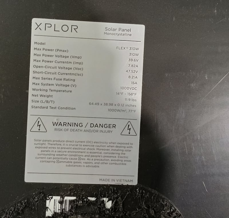

For anyone interested , here is a picture of the 310w panel specs NuCamp sent me (not my panel , but prob from a warranty replacement panel as it appears to be melted a bit)
@B0atguy
Comparing to the sticker on our 310W Sunflare, there is a slight difference in size and weight. Another difference is that the label you posted says MADE IN VIETNAM, but mine has no manufacturing location.
Also, I'd be interested in knowing more about, "something is different about how the solar cells look".

The size difference is probably just from rounding the numbers off, but not sure about the weight ...Stockton, New Jersey
Hard to describe the panel differences , but my old vs new panels are different . The new panel is darker / blacker in color . The cell structure and "lines" going through the panel are different than the old panel . You can even notice the darker color change in the two different label pictures in this thread . Its hard to describe , but they are definitely different . Perhaps they redesigned the panels since the problems.

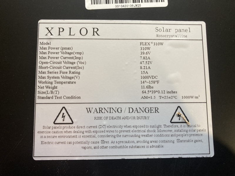

Update on differing Sunflare Explor 310w solar panels . (finally got our 400 uncovered to prep it for travel) .
So, we have a 2024 400 with the single 310w solar panel (on the rear) . Stock from the NuCamp factory , with a build date of early 2024 . Works ok , seemed to be diminished output since new, but NuCamp tested it and says it ok .
While at the NuCamp factory for warranty work , I had them install the 2nd 310w solar panel on the front (Black Canyon upgrade) . This panel is brand new , as I got a message from NuCamp while my 400 was at the factory , that they just got a shipment of panels , and if I wanted it installed . Date - October 2025. Both 310w panels are controlled individually by 100/30 Victron smart solar controllers . Two Panels , Two Controllers .
Right away , I could tell visually that the panels are different. Same size, but different.
The new panel seems to be performing better , and also seems to be a higher VOC . Low 50's on the new panel , and high 40's on the old panel . This could be due to the age of the old panel vs a brand new panel , but Sunflair definitely updated the 310w panels . Other than physical size , the panels are distinctly different in how the panels were manufactured .
Again , slight performance difference could be from age of the old 310w panel , or that the new 310w panel is actually better ? Will prob. never know !
Here are some pictures of the old 310w panel vs the new 310w panel . Both Sunflare Explor 310w panels .
1st TWO pictures are the OLD panel (early 2024) , 2nd TWO pictures are the new panel (10/25)
