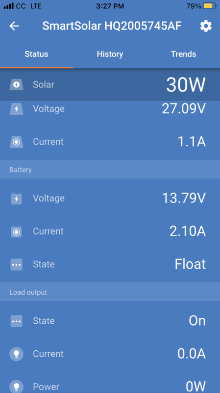

    t=0: Managed to get to the trailer
    shutdown = all breakers turned off (includes inverter)
    battery on:
    Q: What's the 35 watts doing?
    2020 Toyota Highlander + 2021 T@B 400 BD
    Truckee, CA, expat, now driving out of Reno
  • MuttonChopsMuttonChops Member Posts: 1,851
    35 Watts is the present output of the Solar Panel;  P = V * I  . . . 27.3V * 1.3A = 35.5
    Solar Controller is outputting  13.8V * 2.4A = 33 watts to the trailer 12VDC system.
    You would need to see the Shunt to say more.

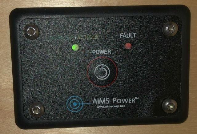

  • geoBgeoB Member Posts: 106
    edited September 5
    t:+ 30 hours
    All fuses pulled.
    Here's a photo of the inverter switch after pressing its button. Before there was no light; now there's a green light. My guess is that the inverter was on from the start - but who nose?
    Victron's contribution:

    Your wording on the Inverter Control Panel is not clear to me.
    As it appears you may have turned the Inverter On which was not the goal.
    If there is either a Green or Yellow LED on then the Inverter is On. No LED equals Inverter fully Off.
      Yellow   LED  =  Inverter outlets powered by shore power
      Green LED   =  Inverter outlets powered by trailer battery
    Attached PDF file as part of a Forum discussion on how the Control Panel functions.
    As for the Solar Panel Victron screen . . . no comment.
    A screen capture of the Victron SmartShunt is also needed to understand what's happening.
