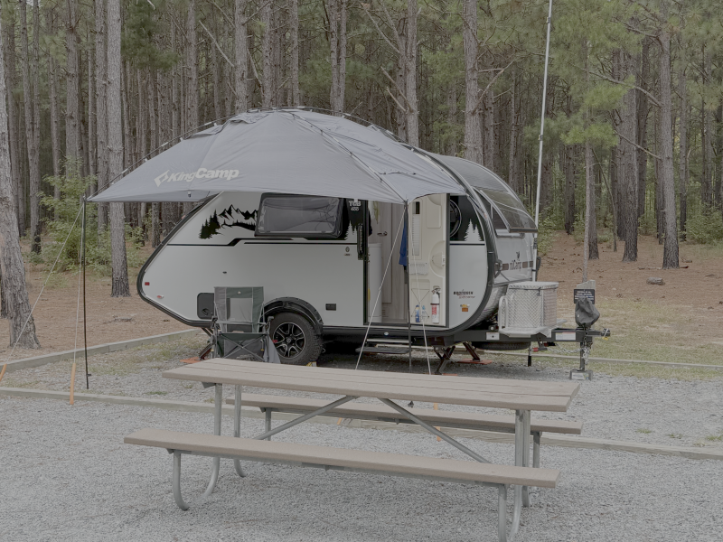

    I use a KingCamp SUV awning.  I ended up sewing on a Keder rail strip as I liked how it made it more secure.
    Pros are:
    • it was about $120
    • it's great when it's raining as it keeps water out of your trailer when going in/out
    • it keeps the front of the trailer cooler when it's hot
    • it provides shade for two people to sit
    • it packs up nicely and doesn't take up much space
    Cons are:
    • It takes about 20 minutes to get fully setup if you count nailing in the tent stakes (but much less time than what I read for people with the nice All Pro or Pahaque varieties).  Tear-down is much faster
    • it flaps a lot when it's windy and may blow up and over the trailer in high winds
    • putting up in breezy weather by yourself is a creative process
    • taking it down in breezy weather is a creative process
    Involve a friend if you set it up for the first time.  You'll figure out how to set it up by yourself soon enough.  The sew-on keder rail insert strip made it even easier to attach.  Hire a seamstress who has an industrial sewing machine to sew on the strip.  I hand-sewed it and it took foooooreeeever.
    After being awakened in the middle of the night from a fast moving storm that blew it up and off the front of the camper (before I had the keder rail insert sewed on) I've been trying to figure out an easy way partially disassemble it without fully removing it for the evening or times when I'm away from the camper. I've got a half-baked idea that involves unclipping the supporting poles and rolling all the poles up in the awning all the way to the keder rail like a rug.  And with some well placed sewed-on velcro strips I could let it just hang rolled up on the side of the camper.  I was going to try using carabiners at the base of the tent stakes to let me keep the stakes in the ground, but quickly disconnect for temporary roll-up.  I am going to try it out when I have the time and I'll post if it works.
    There is a post somewhere were someone built and drilled some brackets into their Tab frame to hold a pull out awning.  However, I'm not that industrious or brave to drill into my camper frame.
    I really do enjoy having it on and love, love, love sitting out under it with a nice soft rain or staying cool in the shade.  I can't find the King Camp for sale on Amazon anymore but this Hasika is almost identical.

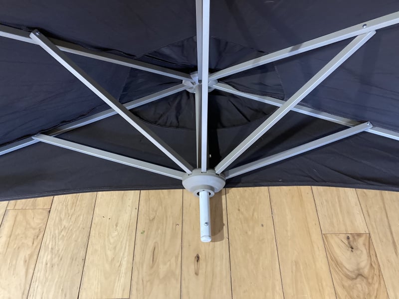

    The original half umbrella we purchased from Ikea for $30. After a couple of seasons it was worn and faded. We liked it enough that we purchased this more expensive one from Home Depot. It's larger and better built, so hoping to get more life from it.

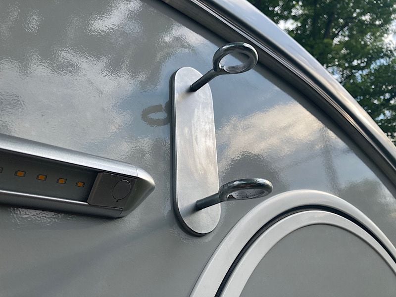

    I mounted a couple of eye bolts by the door that the umbrella pole slides into. I cut the pole down so that it doesn't extend too far past the eye bolts. It drops in place and can be removed in seconds.

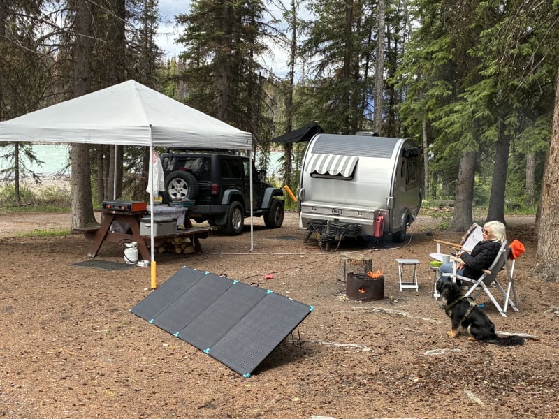

    When we want better coverage, we use a pop up canopy that can be setup in more convenient locations at the campsite. It has optional bug screen and wind break side walls when necessary.
