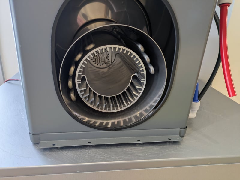

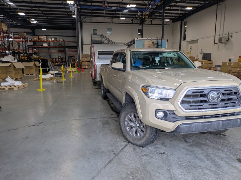

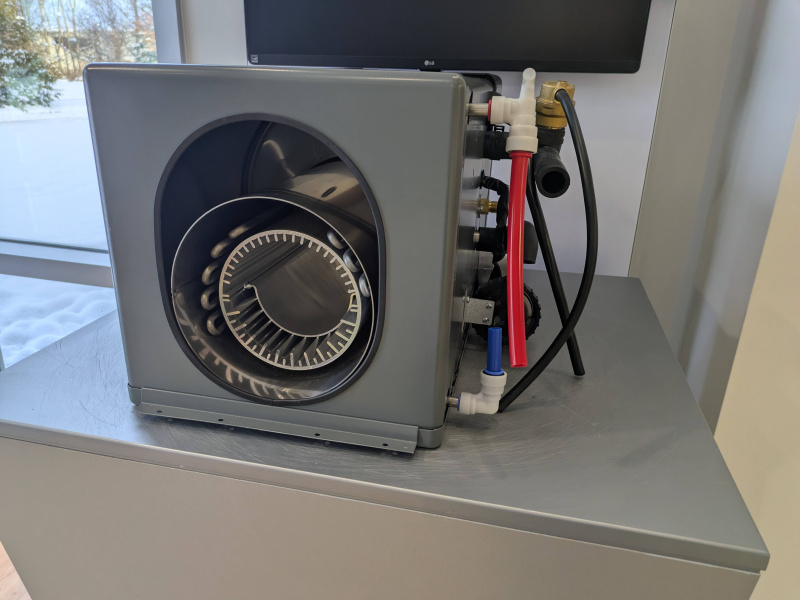

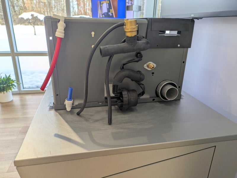

The actual appointment was about 3 hours. The work was all done indoors in their climate controlled warehouse. They had me sit out in the waiting area which also doubles as an area with displays of all of their products. The display units are interesting in that they are cutaway models and show all of the chambers within the Alde. This became very helpful because my service tech was giving me updates as he went along. He would come in from the warehouse and use the cutaway display model to explain how the system works.

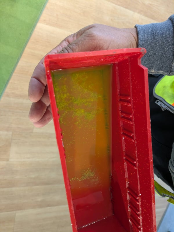

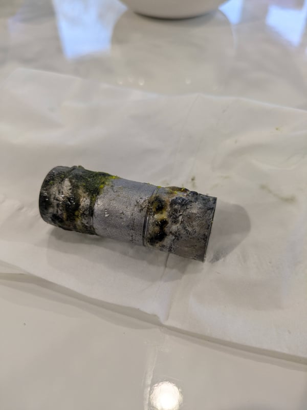

Next came the flush. He did not think it had been flushed in quite awhile. The tale tell sign was that 3 of my aluminum thru-pipes were corroded and beginning to swell. 1 of the thu-pipes is actually a check flow valve and was pretty buggered up. The other 2 simply connect 2 of the black heating tubes. I had those all replaced and the cost and labor was nominal but was in addition to the cost of the flush. The other problem that he noted was that there was a decent amount of sediment in the glycol. He said that the method he used was to flush lots of water through the system using several of the openings and attempting to get as much of it out as possible. After that he was able to start pumping in the new glycol and replacing the water.

Of course it can't be said enough that one of the big benefits of having the manufacturer service the unit is all of the helpful tips. For example, I did not know that the big black tubes are supposed to not have anything on  or around them. The tubes actually put off heat and assist in warming up the spaces they run through. It was also helpful to see a cutaway version of the unit. The inner chamber is heated up by the burner, the middle one is where the glycol circulates, and the outer area is for the water. He did emphasize that if you're using electric to first start it with propane to get it up to temp, then switch to electric to maintain it. Along those lines, mine has 2 electric "levels". He said there are 2 heating elements and to always run both.
Some other tips he shared was to always keep the yellow drain valve open when it's winterized. The thought there was that there is always a chance someone may operate the water pump and potentially pump some water into the unit, which may freeze up and cause issues. He also showed me that the lowest spot is where the cold water (blue) pipe goes in. As far as using the propane in the winter, he recommended using a propane tank warmer.

    Just curious, did you chat with the rep. the reason for the corrosion just on the stub ends or through connectors (and not other places in the system)?
    Is it lack of fluid flush  every 2 years, lack of  coating compound on the stub ends, poor clamping, etc.  fluid type (yellow or grene/blue).  TY

    It's interesting that one of the heating elements looks larger than the other. This is different from other cutaway I recall seeing.
    I wonder if that's a European model. Those have two different sized elements compared to US models.
  • AnOldUR
    AnOldUR Member Posts: 1,740

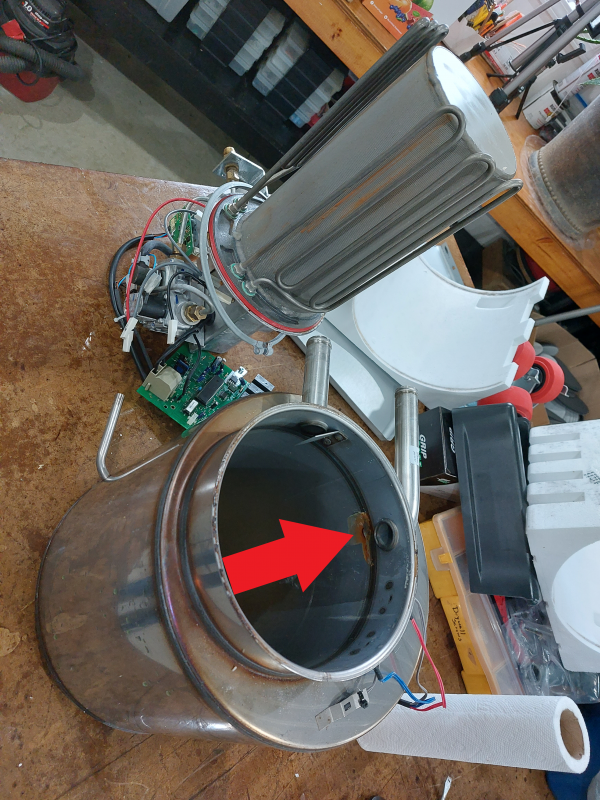

    Good eye @Scott. Everything I've seen has two 1000W elements. My guess is that the furnace in @YoloCampe's post is not what we have in our T@B's. Here's a picture that I believe came from someone here who had to do weld repairs on their Alde.

    What I heard was that it was just a lack of having it flushed and replaced in a timely fashion. The only other part that he did not replace but said to do it on the next flush was the hot/cold mixer valve. That part has been updated since my model. It had some corrosion showing but he thought it would be fine for this round.

    As far as the Alde corrosion issues go, this group has extensive experience with the what and why the corrosion happened.  Generally, the thought is that poor construction practices, bad clamping, etc, led to glycol being trapped under the hoses that attach to various aluminum components. Alde and NuCamp has never admitted this happened the way we think.
