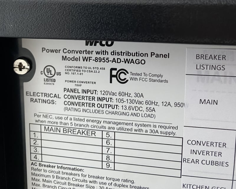

  • B0atguyB0atguy Member Posts: 258
    edited December 2025
    On our build - 2024 400 . We installed 900Ah of lithium batteries and a 3000w Renogy inverter / charger . Since the new 3000w inverter is charging our lithium batteries , we isolated the standard WFCO converter charger to its own breaker on the WFCO breaker panel .
    BTW, We had no issues with the stock WFCO charging our lithium batteries .   The auto detect feature worked just fine .
    Our 3000w inverter / charger is charging our batteries at 75 amps , if we turn on the stock WFCO charger , along with the inverter charger , we can charge up to 130 amps if needed . Also , its good redundancy , that we have the stock WFCO 55 amp charger incase the inverter charger stops working . Usually we leave the stock WFCO charger breaker off , and let the inverter charger do its thing since we can customize the battery charge parameters unlike the stock WFCO charger . So for shore power charging we have either 75amps(inverter charger) , 55amps (stock WFCO) , or both at 130amps . Also have 620w of solar on the roof .
    The stock breaker box setup has the converter , 1200w inverter and rear cubbies on the same breaker . We removed the stock 1200w inverter completely when we installed the 3000w inline inverter . The rear cubbies feed , we moved to another breaker in the breaker box . In essence just leaving the converter breaker by itself that we can turn on or off at will . Usually we just leave it off.
