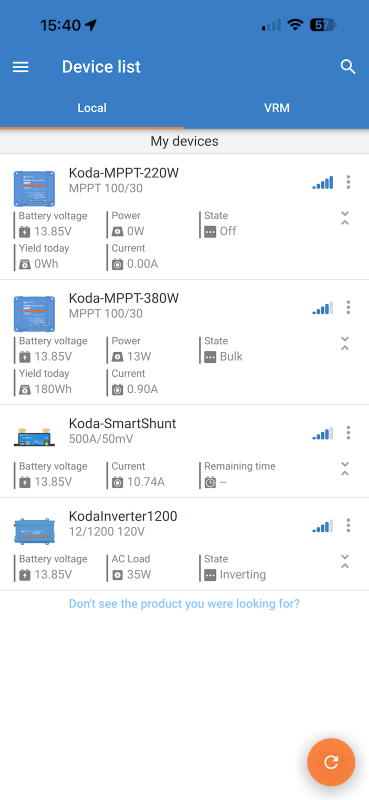

    WOW...what an improvement!!! Used to go up to 13.2 or so...now it is at 13.85 and rising!!!
    Affected T@B owners should get the jumper sent to them to install...simple and fast.
