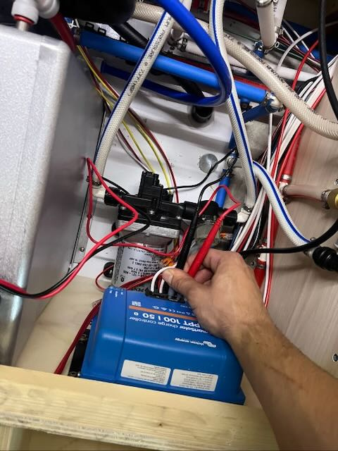

With the help of an electrical engineer (and a lot of patience!), we've completed quite a bit of troubleshooting:
- Battery side of the MPPT is normal.
- Inline PV fuse tested good and was replaced as a precaution.
- MPPT communicates normally via Bluetooth.
- We disconnected the incoming PV wiring from the MPPT and measured the incoming panel voltage directly.
- During one failure event, the incoming PV wiring measured only
0.6–0.7 V, suggesting the controller was not receiving usable voltage from the solar array at that time.

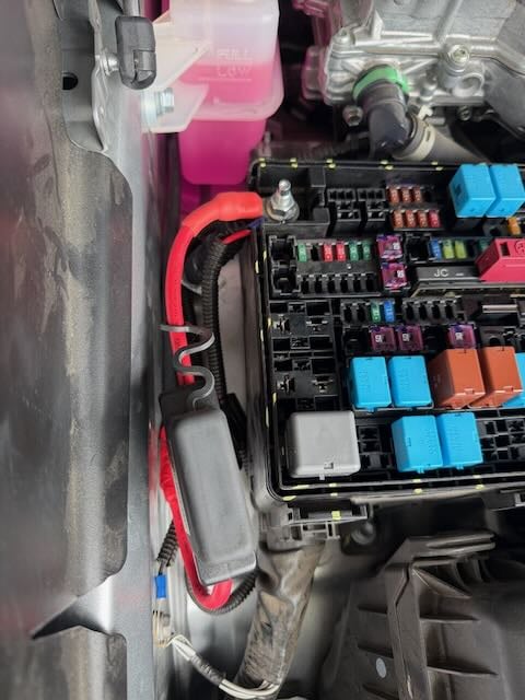

To get 50 amps safely from the TV alternator to the trailer battery through a DC DC charger you need at least 6 AWG wire for the whole run. Is that what you installed?
Rich2019 T@b 400

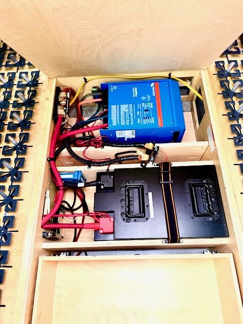

@Horigan Yes , While they were at it upgraded the off switch which was too small for the Inverter and put in bigger breaker for the whole system. I had MEL hinge the door for the battery compartment and put a strap on the Alde compartment cover to make it easier to access when flushing the system . Someday want to see a better way to keep that cover secure without using the screws. MEL will now just use 2 screws for the Alde compartment.
@SavvyNurseCamper My concern is the wire diameter from the TV alternator or battery to the trailer. The standard wire run through the trailer connector and trailer wiring is 10AWG, which has a 2.5mm diameter conductor and supports 30 amps. If you try to drive 50 amps through that wire it will overheat and have excessive voltage drop, thus being a hazard and defeating the function the charging. If you're going to drive 50 amps to the trailer, you need a dedicated 6AWG (4.1 mm diameter conductor) wire all the way back from the TV battery to the DC DC charger, including through a dedicated electrical connection across the tow hitch.
Rich2019 T@b 400
@Horigan Thank you for your concern. I checked with MEL Trailer and yes indeed it is 6AWG throughout the truck and the trailer. They did excellent work installing it. MEL will become the west coast NuCamp repair shop besides the one in San Diego. While I was there I met the director for Airstream that was extremely happy with the work happening at MEL trailer. If you ever need work done on your tailer let me know and will send you their contact information . 😉

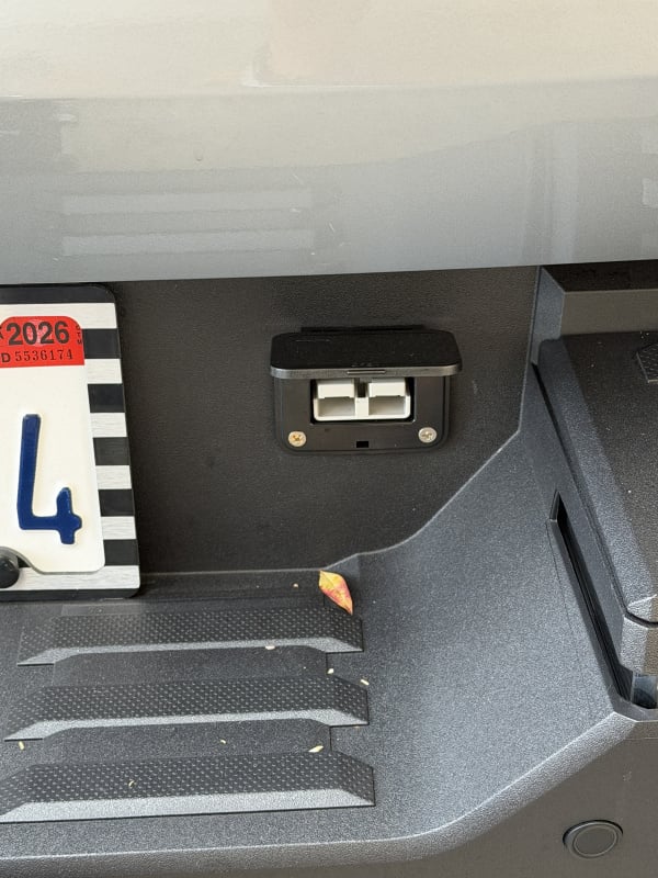

Plug used to pass the power to the trailer.

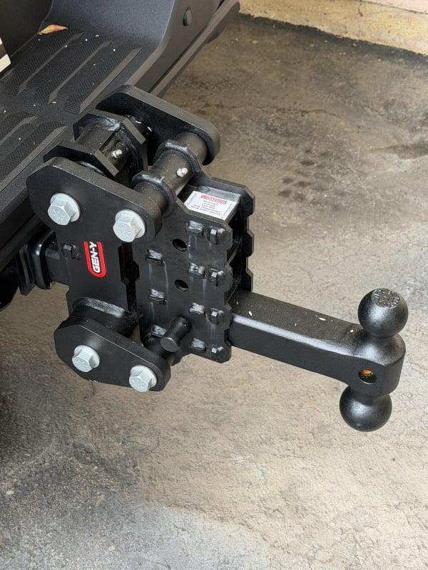

Hitch I am using to tow my trailer . It is fantastic.

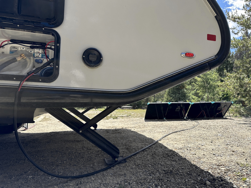

2024 TAB 400 BC 2024 Subaru Ascent Premium Denver and CO Rocky Mtns and CO Plateau

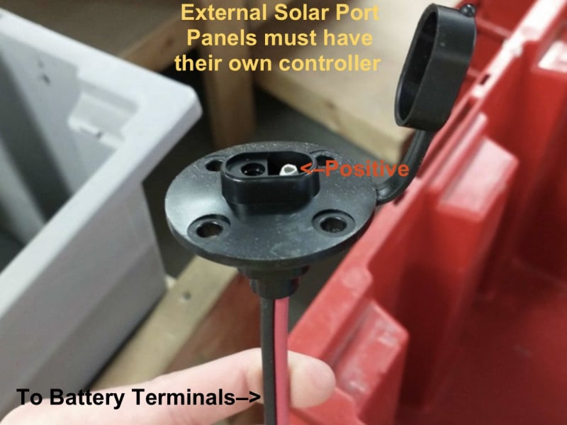

@RockyRichard So the solar port where you tied into in the Nautalis well is suppose to go straight the the Solar Charge controller inside the camper. Was the one inside not working ?
@SavvyNurseCamper Sorry if you (or anyone else) are getting double msgs. I'm not real savvy on posting protocols in a forum setting.

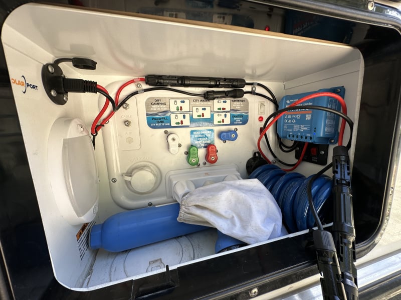

When decided to use temp solar after the panels on the roof bellied up, I spoke with nüCamp rep (probably Jordan Brown) about the external solar connection plug in the Nautilus box (mainly I wanted to know polarities). He explained that it connects directly to the battery, not the solar controller installed by nüCamp for the trailer's roof solar panel(s). You must have a separate controller that feeds to the solar connection plug in the Nautilus box if you are going to use external solar panels. (He sent me the pic below that I annotated.) The Victron 100/50 Controller for the roof panels works splendidly (when the roof panels are working).
@RockyRichard that is interesting. Mine was hooked to the charge controller . It sits right next to the Alde 3030+. Originally when I was given the trailer from Blue Compass I was told it was disconnected . It was not!
I'm in a 2024 TAB 400 Black Canyon. I guess they rerouted the wiring for 2025 models, which may deserve an email to tech@nucamprv.com asking whether there are any limits/restrictions on the external solar panels plugged into the solar port. Response times to my queries have varied from an hour to a week. In the email, I suggest briefly explaining the wiring differences between the 2024 and your 2025 (I have found a couple of instances on my TAB where things were not where they were supposed to be).

The Victron SmartSolar MPT 100 | 50 has only one terminal for battery connection. Are you saying that both the roof panel and the SAE port were wired to the same solar controller? That doesn't sound right and that doesn't sound like something that would've been done at the NuCamp factory.
