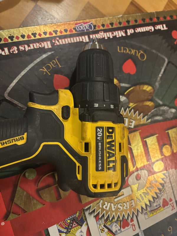

  • jdkoepsell
    jdkoepsell Member Posts: 27
    pthomas745 the drill I was using is a DeWalt 20v brushless.
  • Grumpy_G
    Grumpy_G Member Posts: 789
    The drill shown in the picture has a clutch mechanism with different settings. There should be a setting that doesn't kick the drill out of your hand.
    Have a look at the drill, and if you have the manual, grab it and review the basic settings.  There are several settings that can prevent the drill from "snapping" and twisting.  On the top, there is a "high and low" setting.  On the ring with the numbers there are symbols for a drill, etc. By adjusting the "clutch" (those numbers) it will control how much torque the drill provides before the "clutch" disengages and saves your wrist!

  • jdkoepsell
    Thanks for your comments.  I hadn't understood how my drill worked, with the clutch mechanism.  I experimented a bit and seems to work best set at 9, sometimes needing a nudge with a hand or higher setting when fully extended or retracted.
