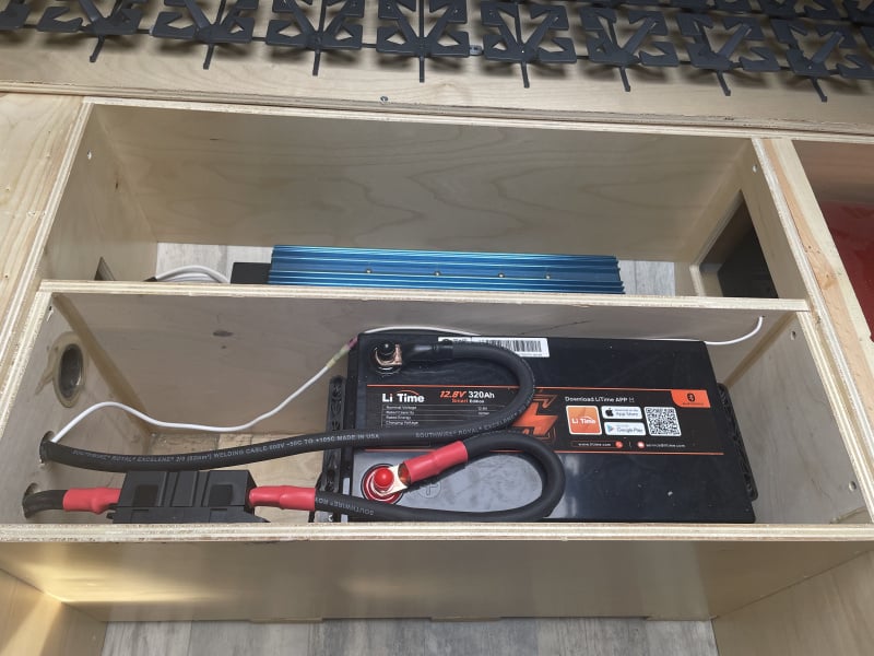

Has anyone installed the Litime 320 ah mini lithium battery in a 2021 400 boondock? We will be changing our harris agm batteries to lithium and this one looks like the fit may be possible though the width seems very close.

    Yes, I did.  Fits perfectly, although I added a small block of wood to secure it lengthwise (2 inches at most).

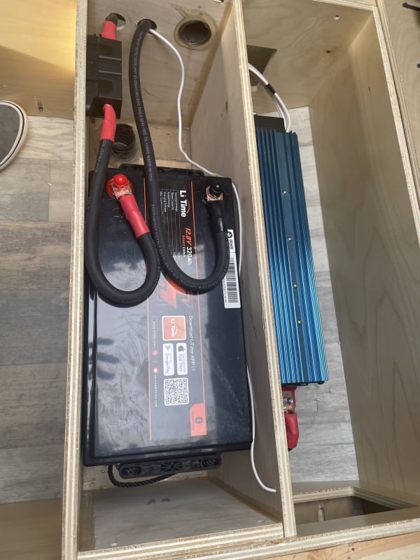

    I don’t know if you got your question answered about the 320ah battery fitting into the existing space where the 2 Harris AGMs are now but I’m also interested. I want to replace ours and if it doesn’t fit I figure I could always move it into the storage space just forward of the battery compartment. This storage area is very hard to access so we never use it. One would just have to secure the battery from moving around and possibly replacing the cables with slightly longer ones.

    I moved the separator wall between the battery space and front storage to get my 320ah battery to fit.  Took all of about 10 minutes to move it forward about an inch.

    I was thinking the same thing. I have opened up the entire area and I noticed a seal around the top of the plywood and ABS vents for the battery compartment. Correct me if I'm wrong but if I go with a lithium battery the vents and sealed area are not needed.

    I figured I would have to move one of the side walls a bit. I like this battery not only for its 320ah rating but because it is self heating. We use our Tab year round and often without hookups.

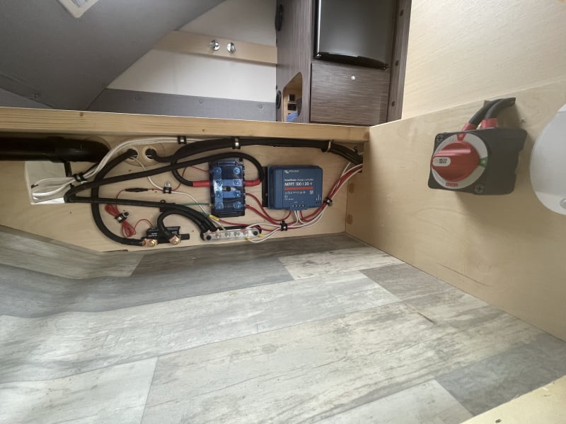

    I plan on installing either a 230ah or 320ah battery with a separate charger located near the battery with the 120v cord accessed from the outdoor cubby. When on shore power I will turn off the battery switch and plug the charger into the exterior receptacle located near the door. Shore power powers up everything and will charge the battery with the correct charger.
    This is true. I used the lower vent hole to bring in my solar wiring and used the upper vent hole to add an SAE plug wired to the battery to plug in a solar suitcase when needed.

    Finishing up my install of the LiTime 320 ah battery. I purchased a LiTime 20 amp charger that I will use with the battery switch turned off and on shore power. Question, can the charger be connected to the distribution block where the battery cables are connected? I want to mount the charger in that compartment and that would make the install much less complicated.

    I installed a Victron Blue Smart Charger along with a relay that switches the charging circuit from the WFCO to the Victron when plugged into shore power.
    If you use the Victron networking and have a Victron Smart Shunt the charger will boost the output voltage to compensate for the voltage drop.  Just setup for Lithium charging and it all works great.

    The LiTime 320ah smart mini fits perfectly in my 22 Tab 400 Boondock original battery space. Added Victron lithium smart charger, second Victron solar controller for the external port, and Victron Smart Shunt. Hope it gives us days of off-grid fun. Kept the 1200 watt Inverter as not looking to use any high draw appliances.
