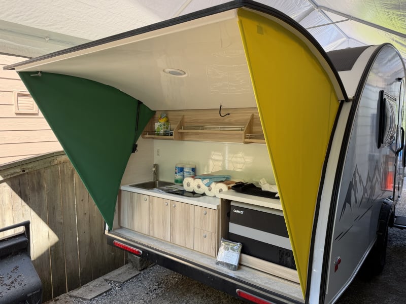

Just wanted to share our latest addition - Wing Walls!  They really block wind and they are very easy to install.  The kit comes with the wings and sewn in poles and enough industrial strength velcro to attach the waterproof, polyester fabric.  One side of the velcro is placed on the outer edge of the hatch and one side is placed on the inside edge of the galley wall.  This makes for a strong effect against the wind.  You must remove them to close the hatch.  Light weight and easy to roll up and store.  They are made by a TaG owner - Meme Eberspacher and are listed on the nuCamp shop Allproadventures.com which links you to her website:  https://www.teardropgalleywingwalls.com/.  She was a vendor at uCamp 2019.

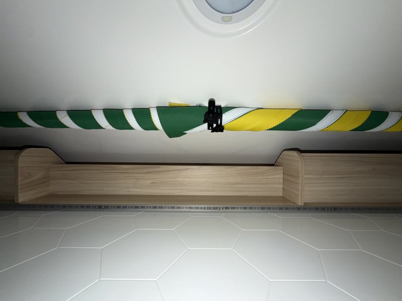

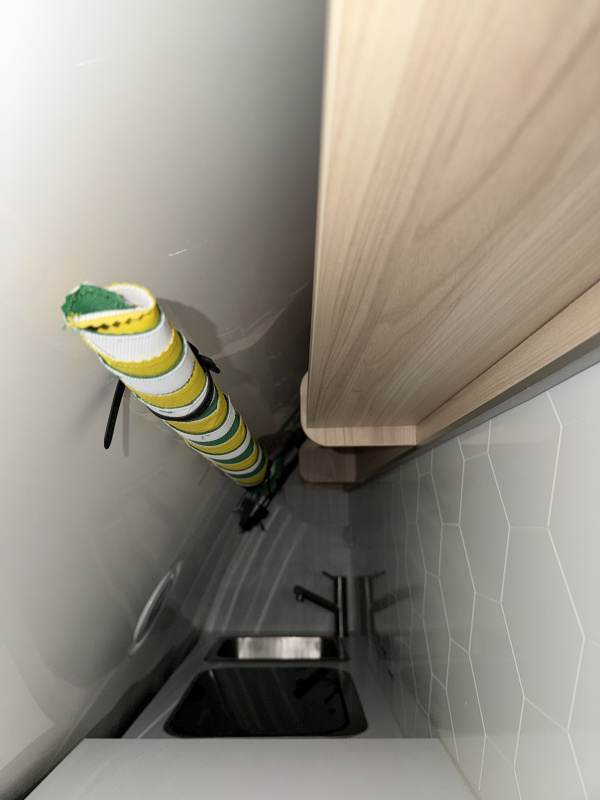

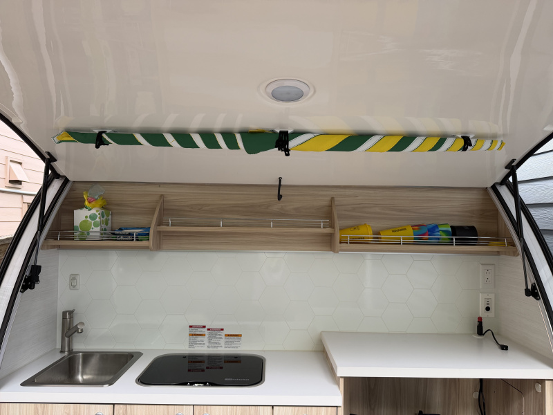

    Got our 360CS Galley Wing Walls from Meme, and they’re awesome!
    The recommended way to stow them is using command strip “wire bundlers” and roll the wing walls up and hang them on the door (see the video on their site).
    But the 360CS has those shelves in the spot, and to lash them low enough to not hit the shelves the command strips bundlers would be upside down at some point - and probably come unhooked.
    So I designed and 3D printed some strap/anchor guides and bought some silicone straps off Amazon. I attached the anchors using command strips outdoor, to better handle temperature variations and humidity.
    The rolled up wing walls hang on the door, just and sit clear of the shelves when the door is closed, and they’re nicely stowed out of the way when we are not using them.
