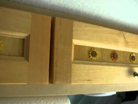

    Here's a video from YouTube showing how to use springs to keep cabinet doors open. http://youtu.be/ULAJAGy3i2M
